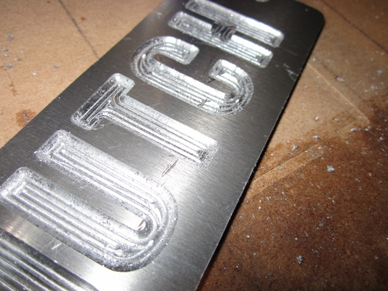

1st try at aluminum
Well you know what they say “Go big or go home” so I thought give some aluminum (1/8in 5052) a try. I wanted 6061 but ordered the 5052 by mistake
All went well all though a bit slow (3-1/2hours) for a 5-1/2 x
2inch carve, I used their recommend settings of 5 in/min with a D.O.C.
at ,003, bit was an Generic 1/8" Single Flute Carbide Engraving bit (10 for $12 on amazon)
Text pocket is .03

Once I started going faster - like 30 ipm, my cuts were much smoother. Now I go 35 ipm at 18k rpms. But I am using an 1/8" destiny viper bit. My depth of cut is also .003.
Thanks for the tip @Earwigger have to give that a try next time
You can go a LOT faster.
I use 16k RPM, 2500mm/min, 1/4" or 1/8" 3 flute, 0.25mm DOC
EDIT: WD40 is not good for cutting, better use 3in1 oil.
Keep in mind, we’ve gone from single flute, to two flute, to three flute. Each jump requires a jump in speed.

After upgrading the spindle and stiffening the machine, I have run some long jobs on 6061 aluminum with:
  • 1/8" flat-end, two-flute, up-cut, carbide bit
  • DOC = .010"
  • stepover = .050"
  • IPM = 25
  • spindle speed = 18000rpm
  • and blowing a fine stream of air and sewing machine oil on the cut point
I really wanted to find a way to mill aluminum without coolant, but when cutting dry it always fails eventually with aluminum stuck to the bit.
Also, tried to make DOC=.020" work several times. Works for a while, but always fails eventually.
When I cut the Y axis braces for my 1000x1000 out of T6061, I used the 1/8" 2 flute upcut ball end mill from Inventables. 611 speed was ‘5’, DOC was 0.1 mm (.004"), and speed was 800 mm/min (31.5 IPM). I was able to cut this dry, with incredible results and no gumming.
@MattWheeler You’re going to slow. I can cut dry, without even air blower, uncoated endmill and no aluminium sticking to the endmill.
What width and depth of cut do you use?
These are my settings for AL:
RPM: 16.000 (dwp611 speed 1)
DOC: 0.25mm
FEED: 2500mm/min
PLUNGE/RAMP: 800mm/min
I use 3 flute 1/8 and 1/4 upcut no coating.
