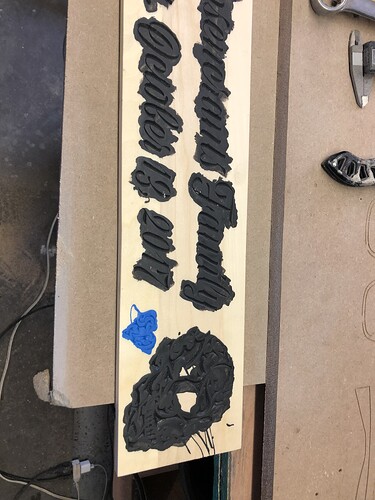

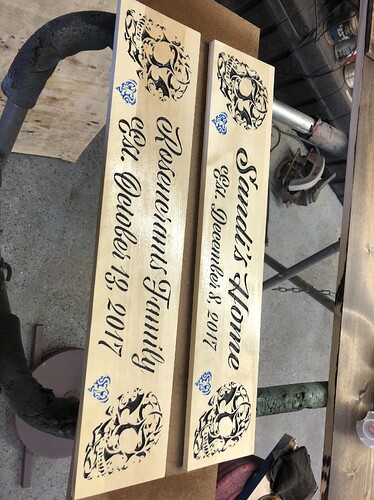

2 custom signs made with aspen wood and v carve/photoshop for font designs

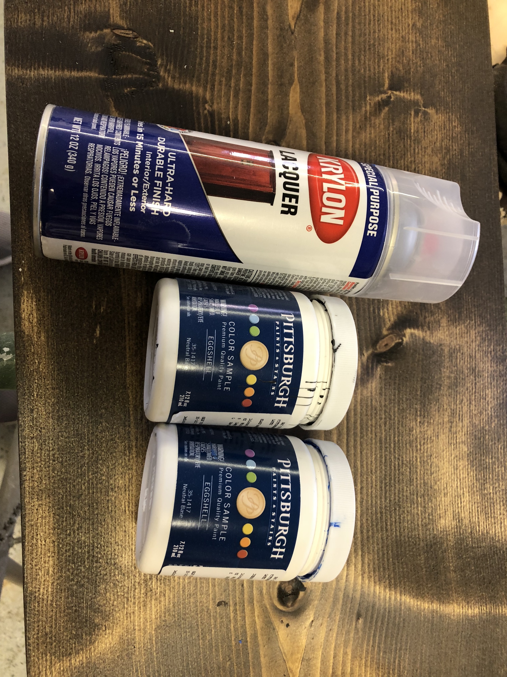

Paints and clear coat that I used.
Everything painted and clear coated. Soon to ship out.
Not bad but i see some paint seepage.
Yeah just a little but the customer isn’t worried about it. She’s wants a older look to it and isn’t picky about it. On some designs I’m laser engraving rather then trying to fight with bleeding or problems with certain woods or paint issues. I’m going to get back into resin work because that tends to work better with inlays or custom designs just milled and not v carved.
