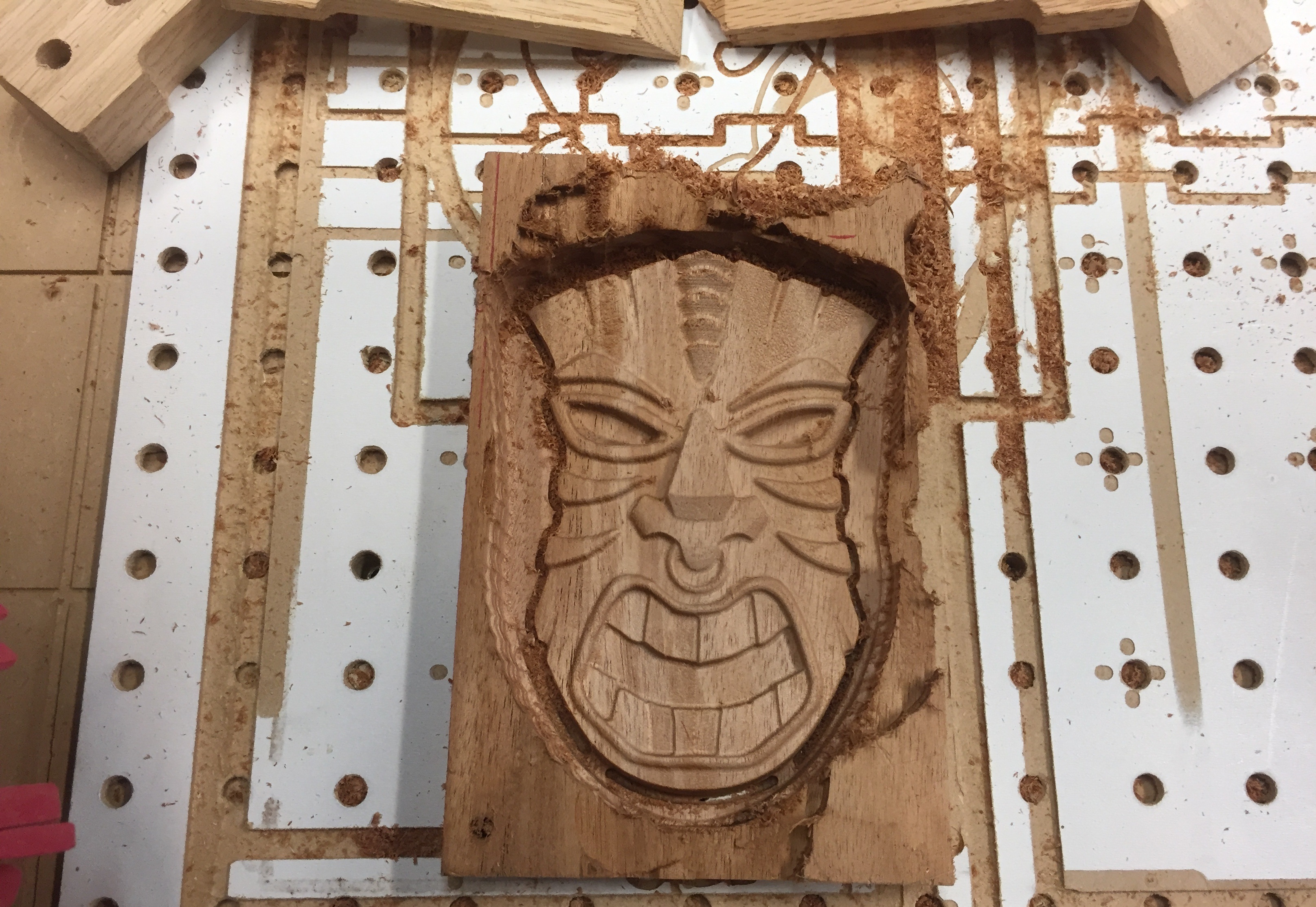

So encouraged by how well the last few turned out I decided to make a tiki out of the last of the teak scrap. I was able to lay out the carve on the remaining bit and it turned out really well.
Finished carving:
Sealed with some tung oil finish:
I am really happy with the tapered bit for 3D carves. I have been using it for the final profile cut as well without any issue. Mainly because I am too lazy to do a 3rd bit change
This was carved at my basic “default” settings (80ich/min). With my original XC I had difficulty carving teak even with conservative settings. Which is why I had the scrap to begin with, from failed / staled carves.
So this really showcases how well the upgrades are performing.
