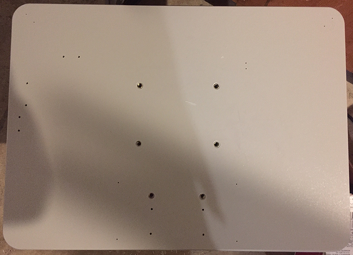

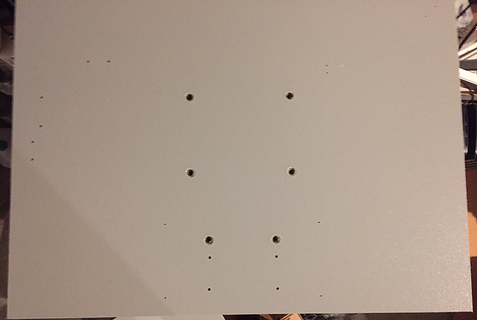

Ok, here’s what I’m fabricating.
Step 1 is to take slightly over-sized blanks and drill 1/16", 3/32" and 5/16" holes. The 5/16" holes are for metal inserts for mounting the tray to an arm.
Step 2 is to route the bullnose edge and 2.5" radius corners on the trays.
I currently mount a template to the tray (using the inserts to orient it). I then use a router table with a an bullnose router bit with bearing. Amana bit on Amazon for reference.
@MichaelPalma
I really think that you could make that entire Piece on the X-carve and eliminate all the other tools all you would have to is 2 maybe 3 tool changes
also the holes drilled would be exactly in the same place every time
or really use the x-carve to drill all the holes and then simply take the piece to the router table for the edges while the next one is being cut
