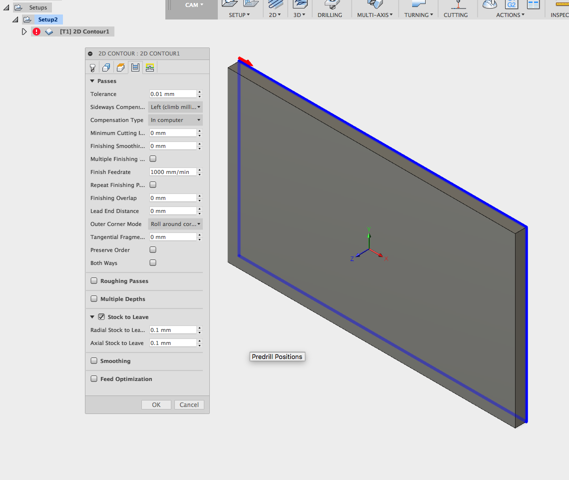

If F360 is your CAM, have you checked “Stock to Leave”?
Hi there sorry to but in but i think this is the issue i have in fusion. please elaborate on this stock to leave. I zero out my z and my first pass will be too deep would this possibly be my issue. been going on a few years and never resolved this as of yet.
@ShaneBell
If you do not edit the default settings in F360, zero Z at actual material height your actual cut depth will be your design Z + 1mm i addition.
You need to edit the stock options under your main Setup folder, highlighted in blue, see screenshot below:
(Set Stock Top Offset = 0mm if you want that surface to be your machined 0Z
Stock to Leave is a preset you can choose under your specific tool path properties.
Purpose is to say leave 0.5mm (value arbitrary) of material from the roughing pass and then do a finish path to shave of the last 0.5mm.
