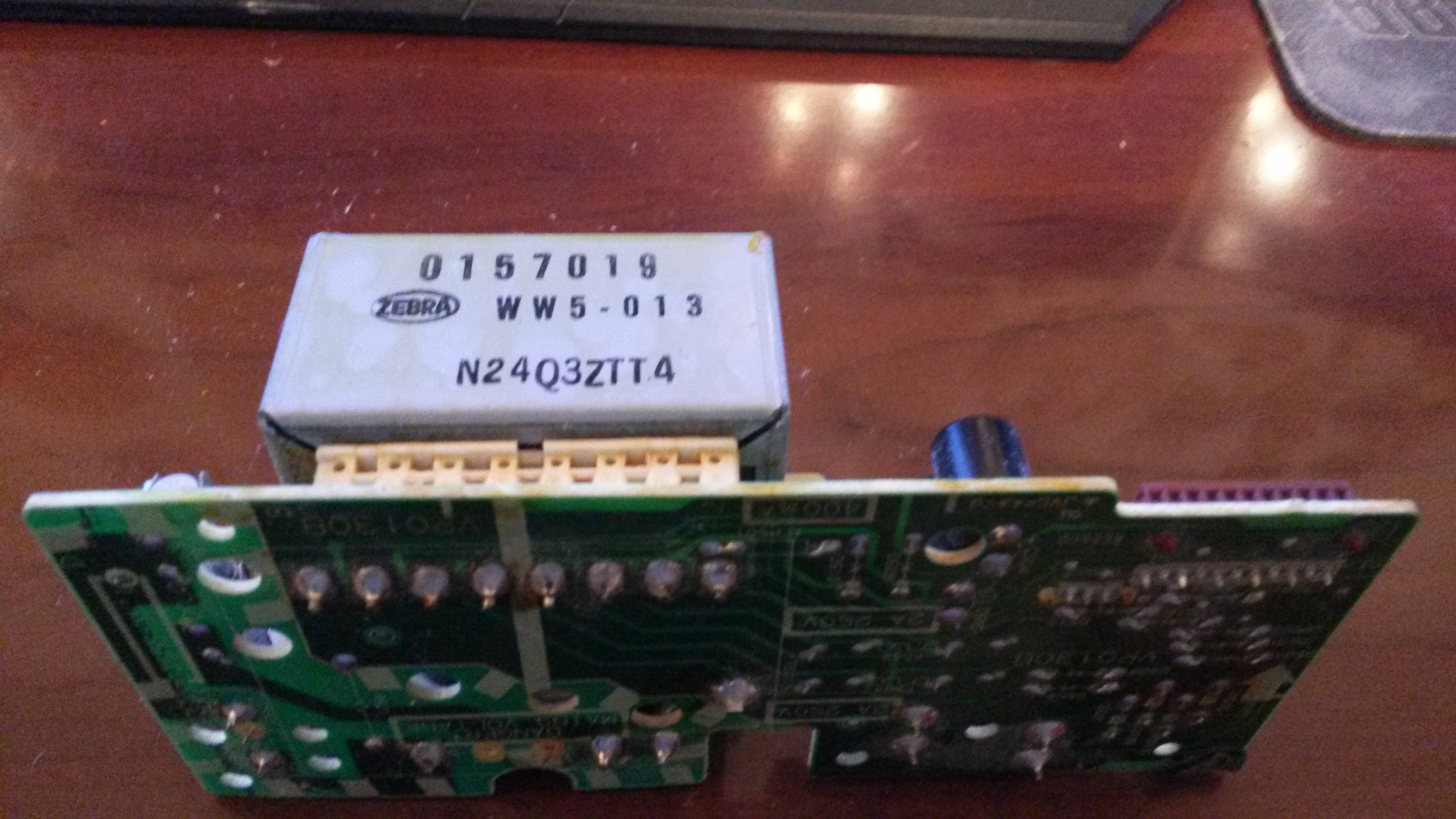

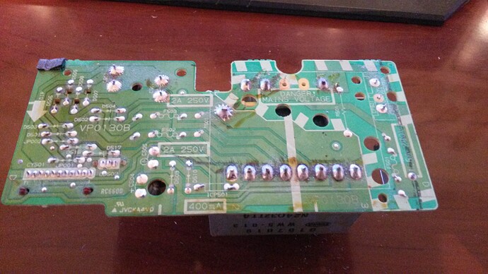

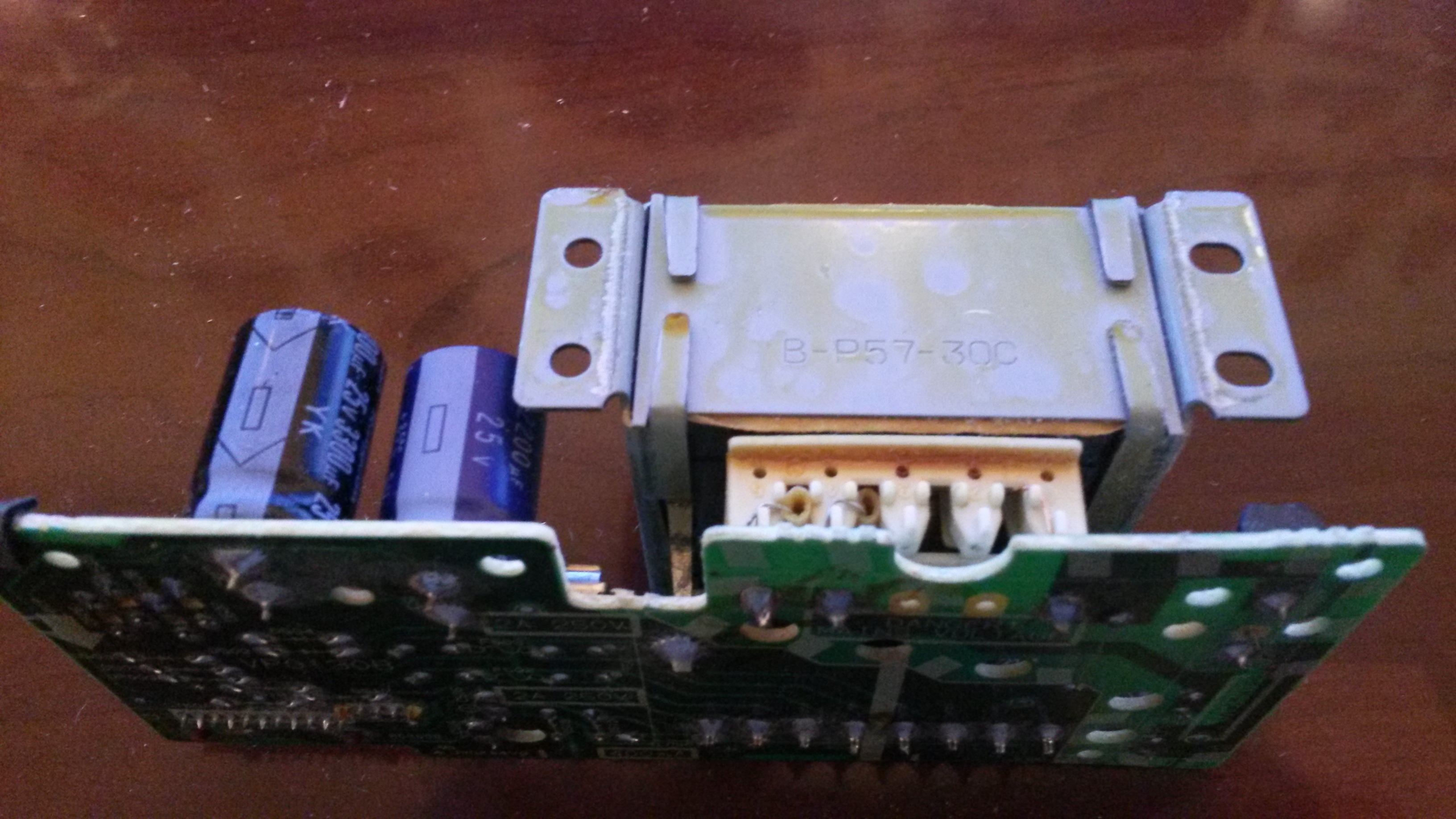

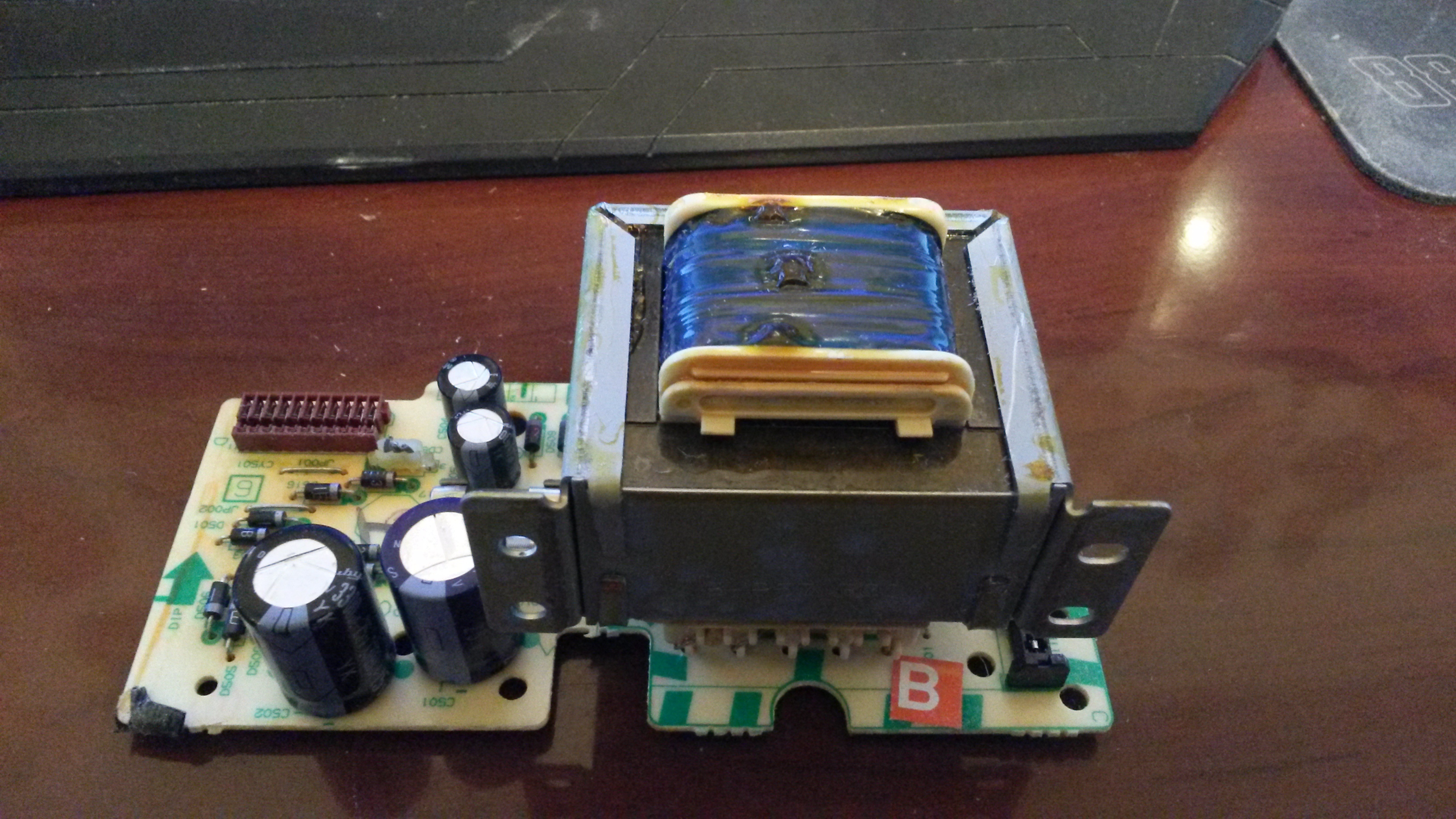

I also have this transformer out of an old crt tv but I cant find any info on it here are some pics will this work? the board it is attached to says 250v all over it so i am not sure that it will work lol
is there a good way to test a power transformer?

this transformer looks old and frankly knackered, I can see signs of overheating on the first picture.
Try looking at an old PC AT transformer there are many voltage options there. check youtube for connections.
My favourite option is Power Supplys, you know like a power supply for a printer etc. I know they are often DC but your heater will work just as well.
Another option is China I found this transformer.
I agree with @NealRobinson, looks overheated.
I have a couple of 12V switching power supplies, as per Neal’s link, for anything needing a low voltage, 30A output, cost about @25 - $30. A lot safer too.

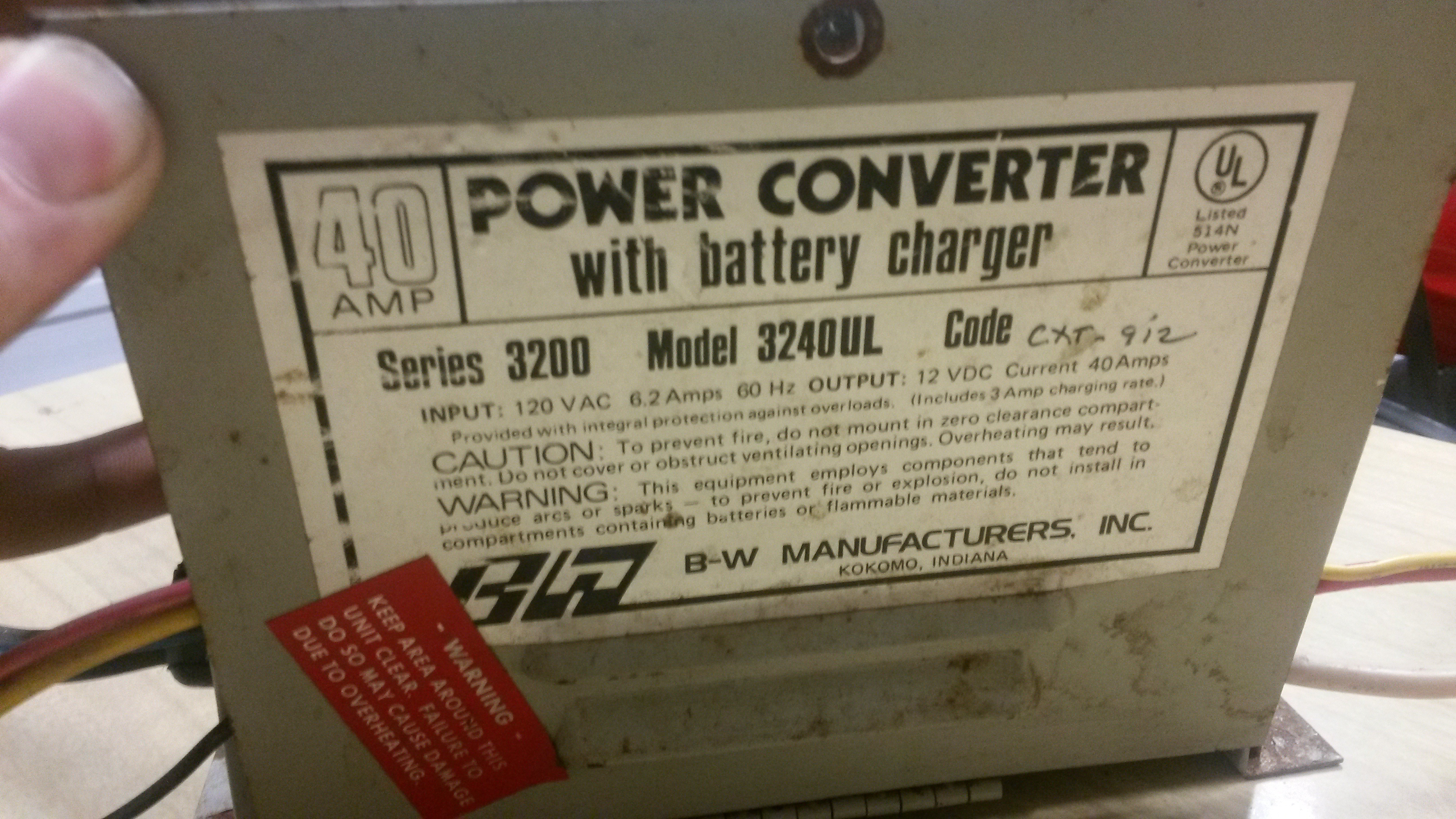

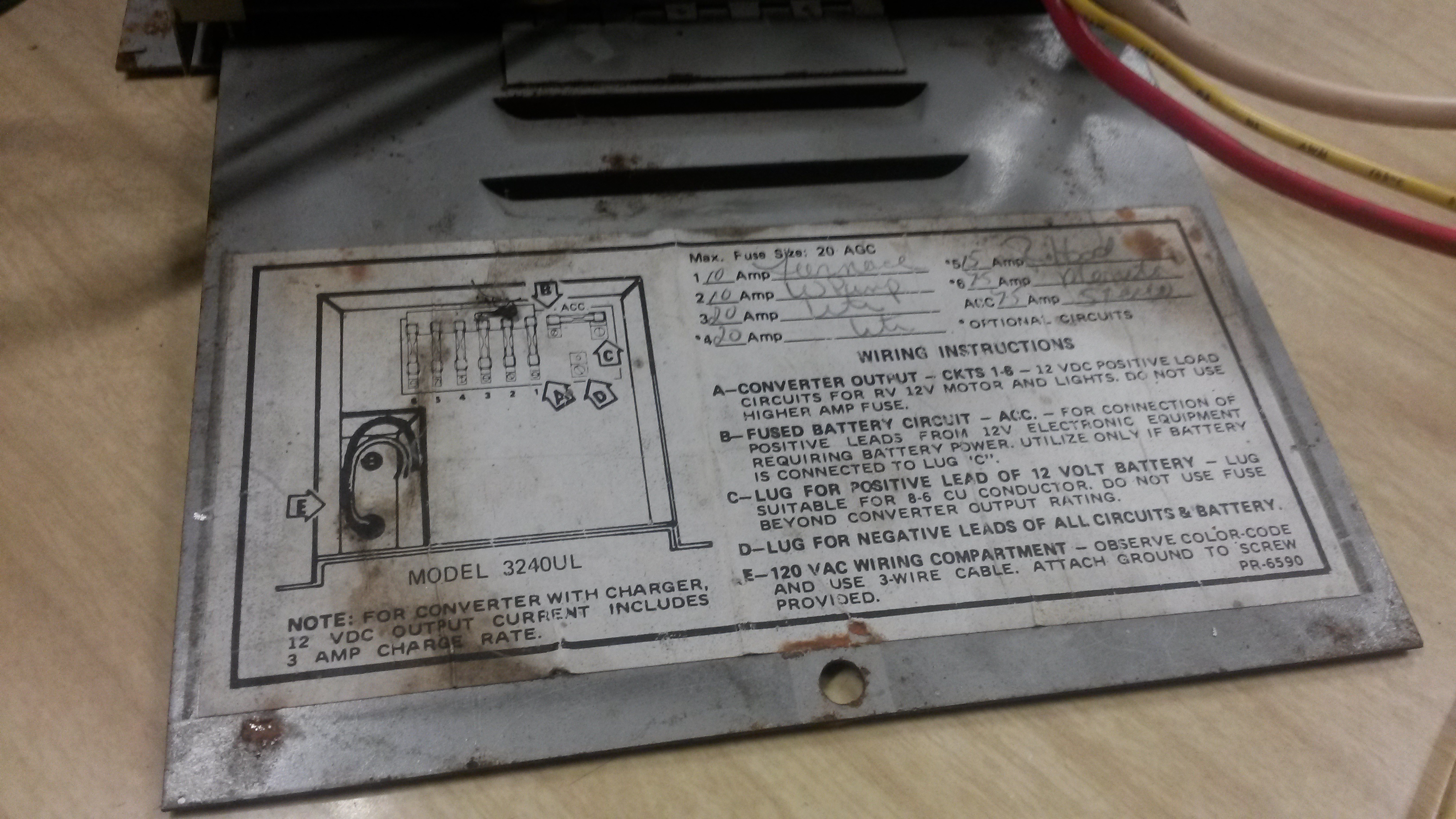

So I found a 12v 40 amp with 3 amp charge battery charger will this work for my project can someone help me on this to get it up and running
Please list what you have as a start.
Then make a list of what you wanna do.
Most of all dont try to “test” the transformer unless you know what you are doing, in theory you can unleash 1000v++ through your body if you connect it the wrong way.
@NealRobinson
@AngusMcleod
alright so here is what i have
x1 12vdc power supply rated for 40 amp max with 3 amp charge

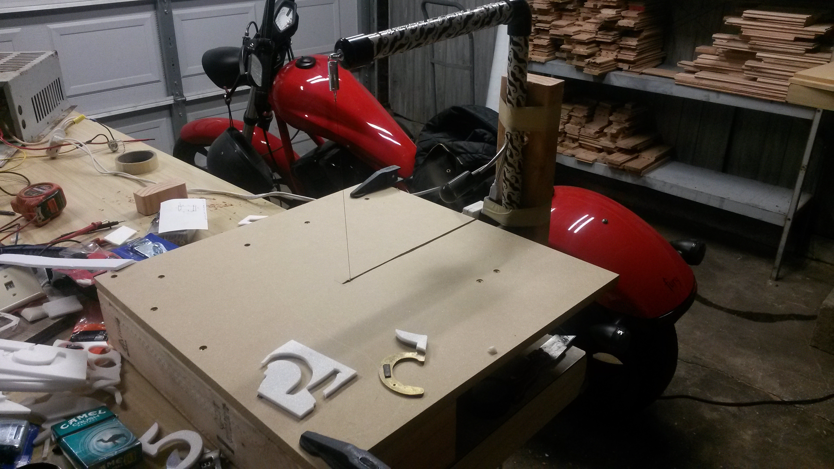

I want to have a adjustable styro slicer I want to in theory adjust the temp of the wire

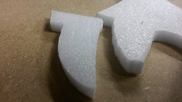

Here is what i have done so far I have hooked up my power supply on the 3 amp side to the kanthal and I get a pretty good effect but its a little hot the wire just barely glows red but it actually cuts the foam pretty decent if you cut it semi quickly
I measured the temp of the wire at I believe 500 degree F I need to adjust it down just a tad
how can i do this
@AngusMcleod
and i realize that 40amp is a bit much but your not going to produce anymore amps than the load that you have on the power supply so if you exercise caution it will be completely fine even 300mA and less can kill you
@AngusMcleod
give me just a second I will take some pictures and I did something to make it cut perfect lol it might be redneck though lol hold on
The cut on the left is with the fan and the cut on the right is without the fan so I need to cool down the wire to get a cleaner cut
