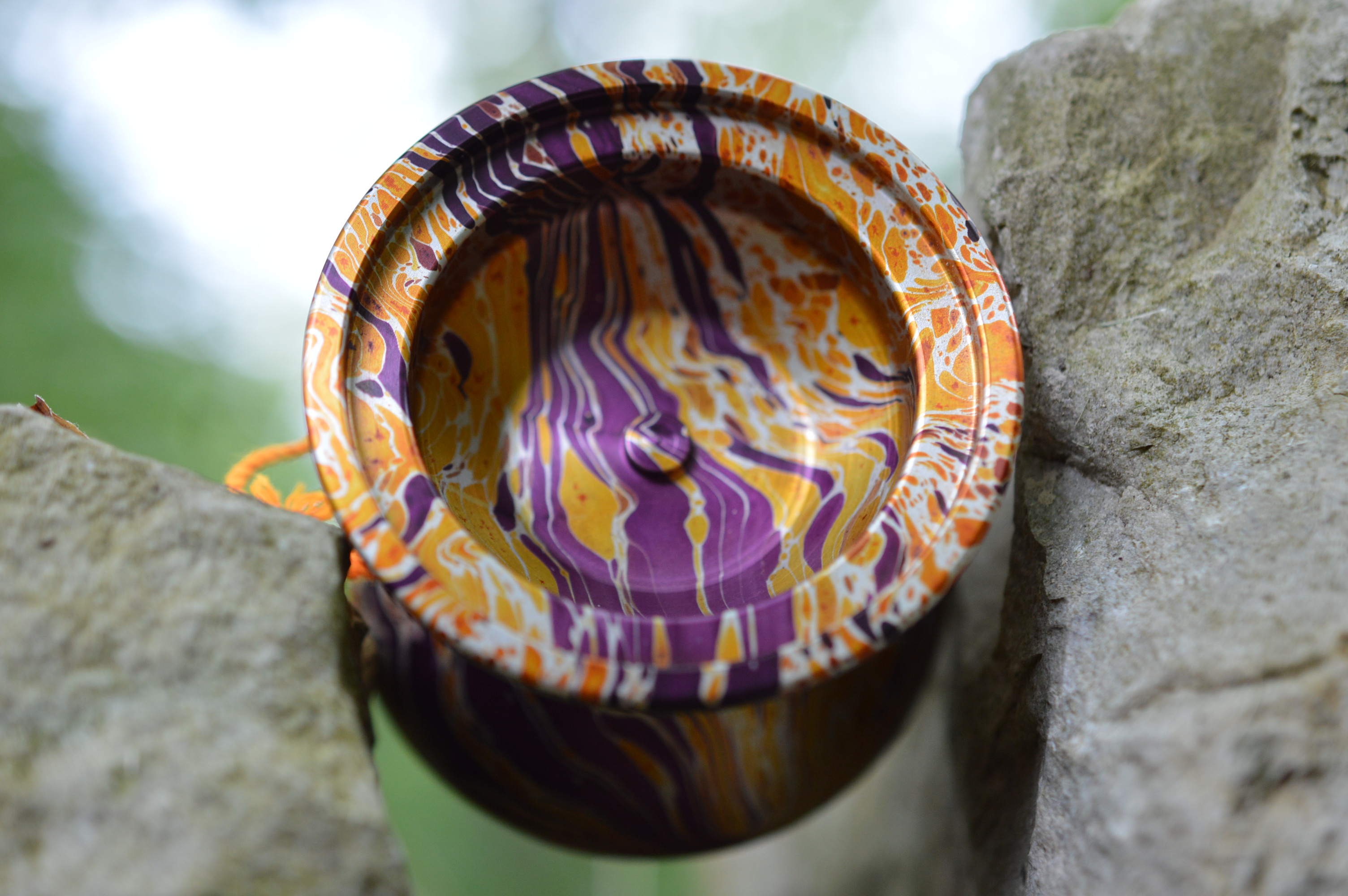

Colors! Can I get colored aluminum that thick? I’m fine if it is just colored on one side or whatever, as long as milling doesn’t make the colored edge chip out or something.
Where can I get aluminum that thick, especially colored or anodized colored aluminum?

If you can find someone local to anodize after you cut, you’ll get full coverage with color. It’s normally not that expensive, especially if they are running that color on another job.
Maybe check harbor freight for a cheap tumbler to soften the edges.
It makes more sense to anodize after machining.
Anodizing is a surface treatment, has nothing to do with thickness of your material. You can’t do 1 side only, its always 100% coverage. Also, and this is important: it does not cover up defects. Your raw aluminium must be prepped to perfection the way you want it beforehand, or it wil show in the anodized product.
Mediablasting or chemical etching is usually done to this effect.
