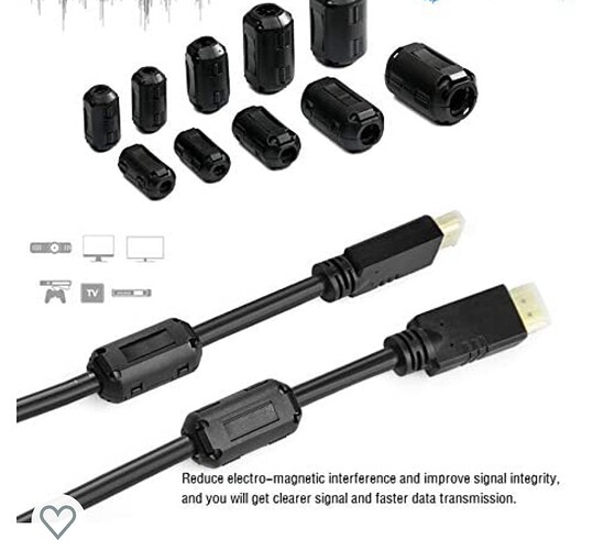

these might help, I used a few of these it resolved my issue. never had a problem since.
![Screenshot_20220118-124829_Amazon Shopping|595x500]
(upload://bMus4VhNYTkzqLUYEnLl5pIgt9Z.jpeg)
