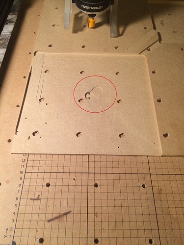

It seems like every day I have a new issue. I finally was ready to surface my waste board so that I could get everything nice and flat and then this happened.
I set it to take 1/16 off the top not 1/4.
I measured all four corners they are consistent within a coupe thousandths of an inch.
I created a fill square with a cut depth of 1/16. I zeroed the bit to the corner at work x,y.z 0,0,0. It slowly went to the middle gradually going to the depth you see and the started making an ever expanding square. When I canceled the job it returned to 0,0,0 right were it started. I would think if the z was slipping it wouldn’t have returned to the same spot it would have been at a lower spot.
I’m not sure what happened but I don’t think the bit returns to “zero” when you exit a project, right? I think it returns to zero in the X and Y axis but the Z axis is at the raised spindle height. If that makes sense.
It was slightly higher like when you hit the raise bit button.

Just shooting in the dark here…
Was the bit tight in the collet?
Is the set screw loose on the router shaft?
Are the 4 screws on your Z rail tight?
I’m asking because it looks like the bit dropped to the top of the work piece about 3 inches into the job. Then I’m thinking the bit started to dig itself in as the X and Y was still moving to the start of the cut. By then the bit was already biting into the workpiece pretty good. Then the bit held its height to cut out the square. When you stopped the job, the bit had already slipped down so as it moved back towards zero it road back up the work piece.
Otherwise, I’m with the others on the Z belt slippage. Sometimes this can be caused by tight V wheels on the Z rail even if the pully set screws are tight.

Yeah, I noticed what Robert stated too… your cut is set for .0625, your square shape is at .06.
Yeah I created a new project so everything was default settings except I increased it to 60ipm.
If you look at the image you can see I killed it right as it started its second pass. I didn’t won’t it to carve into my investable waste board.

These images seem to show, to me atleast, that the Z-axis dropped - perhaps loosing steps?
So I think I might’ve figured out the problem. I think between my dust boot creating suction on the material and the material being so thin I think it actually flexed and pulled it up into the bit I had it secured but only with two screws at opposite corners.
This morning I tried another sample square but this time in three-quarter inch MDF and screwed it in at all four corners it seem like it actually did what I was supposed to.
God that’s frustrating, it’s the simple things you overlook that always seem to cause a problem.
Does anyone else seem like that could be feasible.
Very feasible…an upcut bit can also pull thin material up and cause deeper cuts.

All the respect you guys, but I can see over 3 mm deeper cut on it. Vacuum, down-cut, up-cut doesn’t cause that.
Loose bit Colette, Low stepper current, Step calibration, even slipping pulley might be the blame.
If that MDF is a little warped, it goes just say 1 mm down. Something mechanically wrong.
