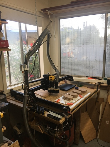

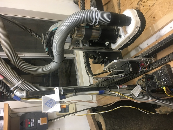

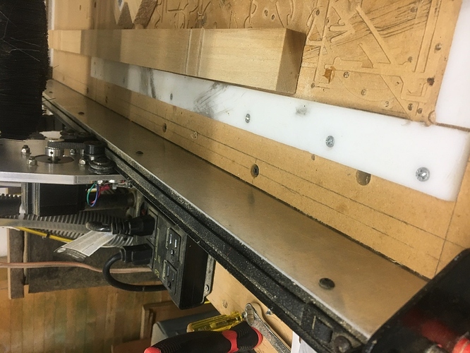

I have an older Arduino Shield controlled X-Carve 1000 that I bought used about 5 years ago. It has the beefier X-axis rail. I would get odd stoppages during a job. I redid the motor wiring using Shielded 4 conductor wiring. The shields are all tied together at one point on the Arduino metal chassis. I also have One wire from that point to the chassis of the power supply. I have two clamp on ferrite cores on my 15’ ft. long USB cable. I use a laptop connected to a different outlet, but same circuit. I use an Iot Relay Bix by DLI, $26 from Amazon. My spindle and controller are plugged into this. I splurged and got an InSinkErater STS-00 dual outlets Sink top switch, $70 from Amazon. It’s an air switch. I mounted the button along side my X-carve. On the right in my case. Now I don’t have to stoop to turn on the Vac. I haven’t had anymore odd ball stops during a run. I think I got the wire from Jameco. These mods were done in 2017 and 2019. I also replaced the Z axis and with the CNC for Newbie one along with their riser kit. I added 1/8” x 4” wide Aluminum sides to my Y-axis rails. These stiffen the rails and keep the chips sort of controlled. I also added an 800 watt water cooled spindle and controller. I gave up 1/4hp versus the Dewalt which was ok because the spindle is heavier. The spindle is also dangerously QUIET. You really have to keep an eye on its controller to make sure it is On or Off. I haven’t sprung for a new X controller. I think I would go all in an get a new lead screw drive machine at that point.
Oops! Wrong pic. That’s the one with the Dewalt still on it. Fresh pics.

is that a canvas cover to the dust shoe? I have never seen that before!
No, I 3D printed a dust shoe I designed. The canvas is part of the nylon dust brush shield I wrapped around the shoe. The shoe is held on with magnets. The brush is available via Amazon. I just looked it up and it is indeed called a dust shoe brush. $13.
