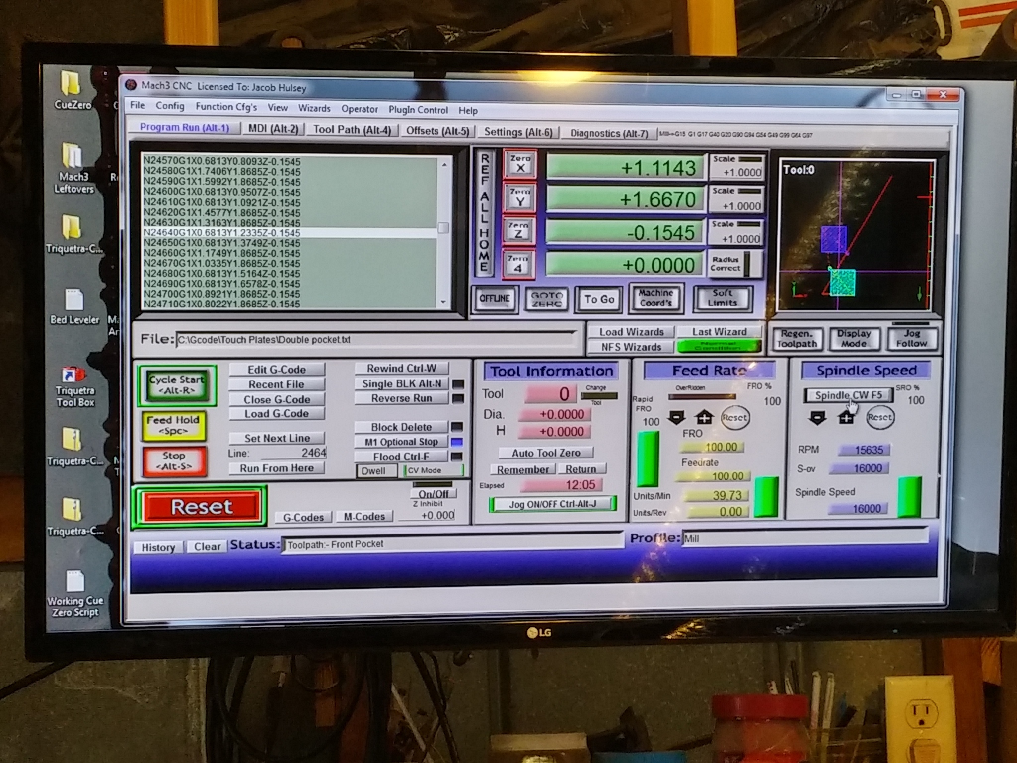

Windows 7 Operating System
32 Inch LG 1080P Monitor (Not a TV) Wall Mounted at the back of the CNC
Mach3
