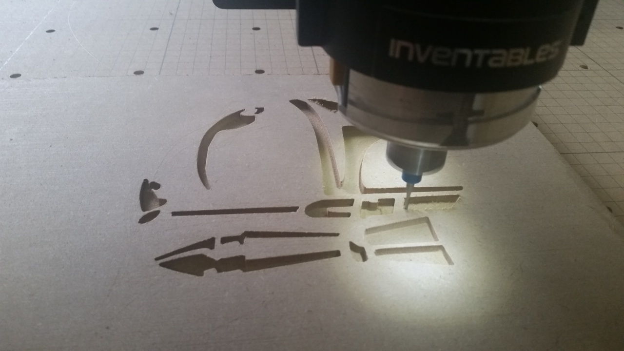

Here are a couple of pics. One of the initial carve and one of the second carve.

Congratulations and welcome!
I remember that first carve, and stepping back 5 feet :slight_smile: Reminded me of the scene in the elevator from Ghostbusters.
Of course, as soon as nothing exploded I had my face as close to the carve as possible like a kid in a candy store.
Congratulations! It is unusual for that first carve to be as nice and crisp as yours. You did a great job putting it all together.

i got one of the end mill starter kits. To do the first 2 carves I was using the smallest bit in the kit which was 1/16th i think. My wife wants to make a sign so this weekend ill be moving to a bigger bit to try.
Thanks. Yea I cheated and was doing a little sanding while it carved to get the little burrs off LOL
Just getting straight lines and a consistent Z depth is a real milestone for the machine.
