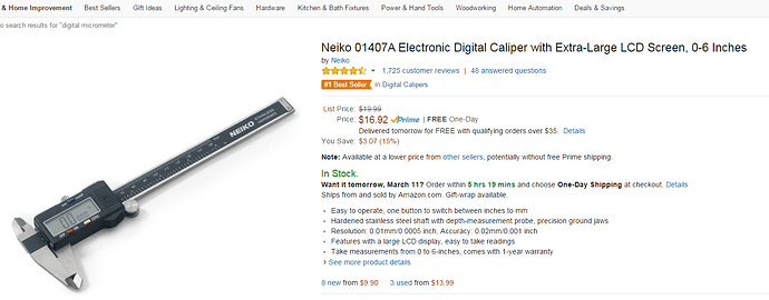

The most important tool next to my X-Carve is my digital caliper. You will need it for every cut you make, since the actual thickness of your material and the actual diameter of your bits is super important to know.

Between Aaron Matthews and @AllenMassey, 's lists you’ll be a happy camper. My bench top belt sander was revolutionary to me. Quick work of tabs on wood, aluminum and brass and I am still on the same belt it came with. I actually prefer a cheap electric palm sander for finish work. Random orbital works better on larger surfaces, but for small stuff, I can hold my cheap palm sander in one hand and touch up small pieces with the other. The random orbital is a bit more difficult to handle. The caliper - per Allen is CRITICAL. Get this stuff on Amazon - dirt cheap. Chop saw and drill are the two tools I use every day, several times a day. The chop saw cuts aluminum, brass, wood, etc. I have one 80 tooth blade, carbide tippped, for metal and one for wood. Changes are quick. I screw my work down to the wasteboard with my drill. I might add one tool for you: A Dremel. I use sanding and buffing and tools but most important to me is tab cutting. They make a little saw wheel that cuts wood tabs perfectly. They also make a little metal cut off wheel for metal, grinding down or cutting off screws, nails, etc. There are also 20 packs of scotchright wheels and make quick work of rough edges and scallops and put a nice shine on metal. That Dremel is SO handy. Have fun.

  • Digital Callipers.
