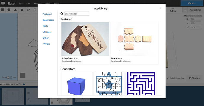

new to the forum so apologies up front. I want to do a relief cut then do a straight cut in another part of the piece for a logo plaque. A lot of it is learning to new terminology in this area. I appreciate the feedback.
No apologies necessary. What material are you using? Also is it detail work or larger items?
I’m not sure what you mean by relief cut but you might take a look at the inlay generator. It will take your artwork and create the cut out insert and the pocket it fits into.
