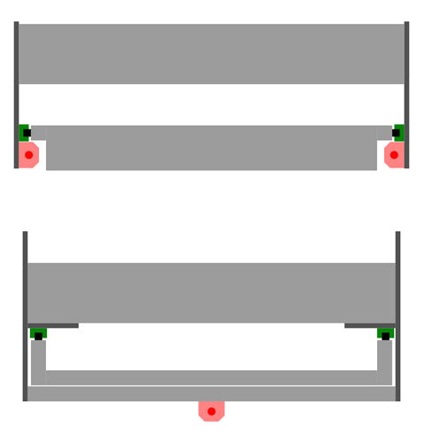

Even though the goal in this phase is the electronics, the majority of the change happens on the mechanics; on the geometry to be specific.
There’s one major change:
(1) switch from dual to single Y transmission
And since this would call for a disassembly/reassembly, it’s a good opportunity to add two minor ones that have been on the todo list for a while:
(2) replace the gantry extrusions with a single piece
(3) extend the Z axis by 50mm in order to add another pair of rail blocks
There’s two reasons for doing (1). More powerful electronics in a dual-Y setup emphasize the importance of sync between them (or the possibility/extent of damage in case of lost sync). There are ways to catch an alarm signal in case something happens to either motor in a dual setup, but it gets complicated. The other reason is that the servos come with a fantastic autotune software feature which best works with one motor per axis. Since the single transmission will be placed in the center between the two Y rails, it’s very important to increase Y axis rigidity to eliminate any possibility of racking when cutting close to either edge.
Using a single X extrusion, (2), is a simplification which apart from making the design cleaner, will also help with squaring, ballscrew aligning and will reduce installation steps. This was a “duh, why didn’t I think of this in the beginning” moment. I had automatically placed the ballscrew in the middle, which makes sense on the Z, but is not so critical on the X.
Last, (3), the Makita is rock solid in the current Z, but it would be nice to have an upgrade path to a heavier spindle. Thus, second pair of Z blocks.
Here’s an abstraction of the before/after for the Y. Rails in green, transmission in red.
