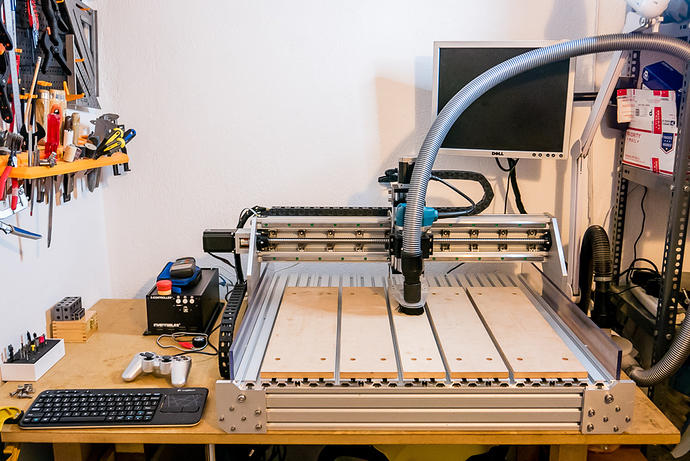

Building B-Carve
It looks great!
Awesome!
Congratulations that really looks like a very capable machine.
really interesed to hear your first impressions and things you would have done differently in hindsight. if any :slight_smile:
Hey everyone, thanks for the stamps and everything :slight_smile:
@anon68752607 some preliminary testing has shown that compared to my X-Carve double material removal rates are possible. When I started I was aiming for 30% time savings. It now looks like 50% and I am confident it can be pushed even further with appropriate tuning of toolpath parameters. Considering that the #1 goal of this build was “sleep more”, this only makes me happy.
One thing I would have done differently which has also been mentioned earlier in this thread: I would get the ballscrews with their ends premachined and ballnuts as a kit. The cost savings were not worth the time penalty. It was almost a couple of extra months of waiting for shipments and trial & error.

@EliasPolitis Awesome work. I’ve just build myself a new machine using the x-carve too, and I think my t-track is similar to yours. How did you attach the mdf to your t-track? the m5 pre-insertion nuts i normally use are too small, and therefore useless.
@JanVanderlinden
I may have used the red button a couple of times in the past year and a half.
Ever since I hooked up the gamepad I keep this close and whenever needed my left thumb finds the button that is assigned to “PAUSE” [which in bCNC toggles between “!” (feedhold) and “~” (resume)] without even looking. This way I can prevent something bad pretty fast and in case I correct it, resume from where I left. Red button=start over.
For instance when milling the holes for the narrowest (middle) wasteboard strip I realized the dustshoe was going to crash one of the clamps: feedhold, release clamp, clamp behind the toolpath, resume, mill “problematic” hole, feedhold, clamp again in original spot, resume. Btw, clamping in 3 places allows you to move the 4th one without moving the workpiece a bit. Kind of like climbing by keeping 3 points of contact while looking for a new 4th.
@BrendanCoutts
The whole build uses 3030 T-nuts like these in various hole sizes (M5 for the wasteboard).
The only exception were the bed-to-frame nuts. In that case I used this type of post-installation nuts, which mount very fast (and very clever, they self align and they do not need to be fished) . Some places call them hammer T-nuts, some swing T-nuts. You mount them on the original part with orientation parallel to the slot of the destination part and they swing and lock at 90 degrees once you tighten them in place.

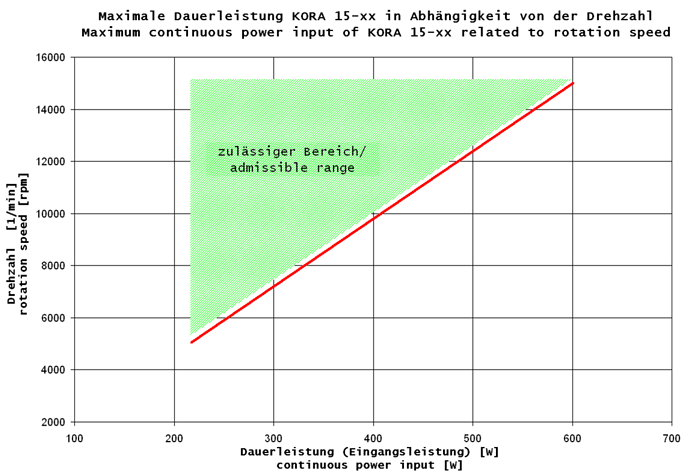

Amazing looking machine, quick question, how long can you run the Makita spindle without it getting hot, I have the same router and I have always been a bit reluctant to use it for long carves as I worry it was not built for that? thanks
I also use a Makita RT0701 router, at speed 1 and 3hr carves the metal base is barely warm.
Hm… this is not an easy answer.
There’s heat from the spindle itself and heat from the workpiece that can transfer from the endmill back to the spindle. There are several factors to consider. WoC, DoC, feed, speed, material hardness. They affect the Watts required for the cut… and also affect the chip thickness which is what takes heat out of the part.
Also, being an air cooled spindle, the higher the RPMs the higher the airflow. On the other hand you cannot rely on cooling by bumping up the speed, since higher speed => higher SFM => lower chipload => risk of rubbing => higher feedrate to compansate => higher MRR => higher wattage => hotter. Looks like a vicious cycle.
Even the material and shape of your spindle mount will affect heat dissipation (for better or for worse).
But then, guess what… having a not so rigid machine (*) has one advantage! It will prevent your router from cutting at high wattage, it will flex and cause all sorts of chatter if you try to push it. This will allow you to cut at lower wattage for hours non-stop without getting (too) hot.
I’ve cut for 5hr and could still touch the spindle after.

For reference, here is graph that shows the effect of a cooling fan on the shaft of a Kontronik model airplane motor. This graph shows the coling capacity vs motor power. RPM has a big influence on the cooling capacity.
