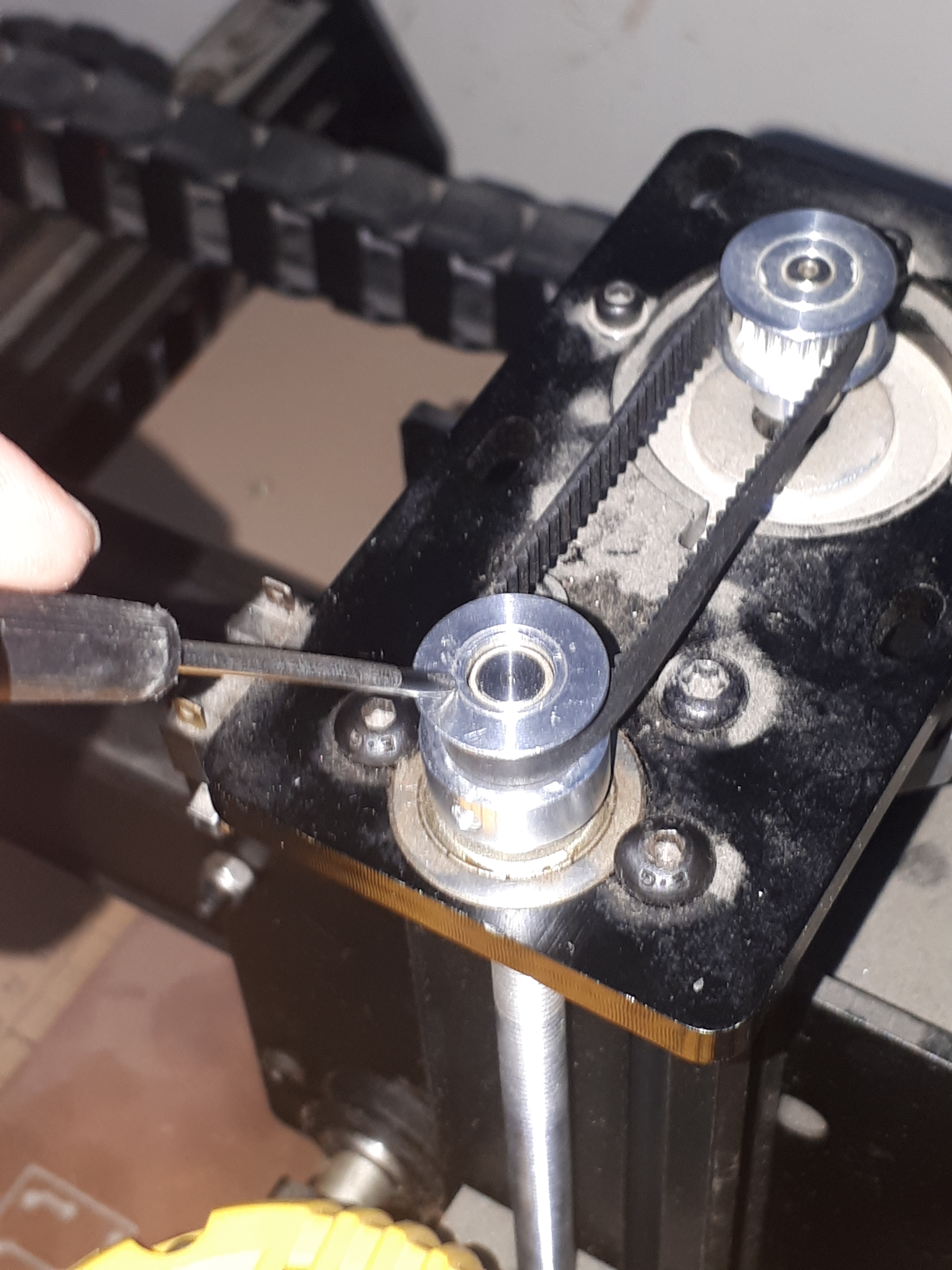

I ran into an issue that my Z Axis not moving and I’m sure that the pulley for the ACME Lead Screw
but I don’t know which one I should buy the GT2 or XML and what size I should buy?
I’m sorry for bothering you a lot.
Thank you and wish a nice day.
I hope you see the picture and the video on the link It shows the issue.

It looks like your pulley is loose. Make sure the 2 little grub screws are still there. Before you retighten them put some blue loctite on so they can’t get loose again
It looks like your pulley is upside down Assembly instructions
