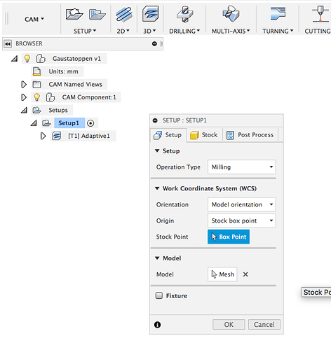

BTW - after searching and asking a little around I have a different approach to offer, entirely within F360 without the need to convert into solids.
  • Download or generate the STL-file for what you want to do
  • Fusion360 -> Insert Mesh
  • Scale mesh to desired size
  • Go directly into CAM envirmoent and under Setup select Mesh as Model

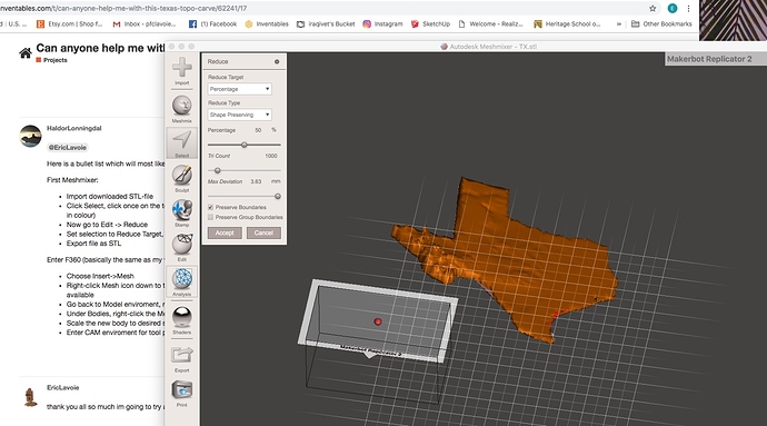

well i get it into Meshmixer get to edit> reduce and there is no place to enter a value
Yes it is, you need to pull down the meny in “Reduce Target” where your screenshot say “Percentage”. Choose “Triangle Budget” and go down to the slider that says Tri Count and type in the target, say 9500.
Click Accept.
BTW - with the recent discovery that one can use Mesh directly in F360 CAM omit the purpose of the mesh reduction steps.
I wonder if that’s a recent update… I’ve been playing with topo maps for a couple of months, and when I first started I tried to go straight off the mesh for CAM as well, but it didn’t work (can’t remember if it didn’t want to select or wouldn’t actually generate paths properly or what, but that’s what started me down the rabbit hole of having to convert to a model).
I think you may be right, I have walked the exact same mile trying to get Mesh to work direct :wink:
I havent taken the time to do topo carves yet but have several projects I would love to do :slight_smile:
As a pilot (recreational glider pilot) I would love to do a large scale topographic 3D map of the terrain we use to fly in. Due to size I consider tiling it which can easily be done with sketch rectangles as CAM boundaries.
Direct Mesh -> CAM work just fine now, also with high facet count models. (but F360 do slow down with high facet count…specifically during tool path generation)

F360 do have a learning curve, but as posted here you may omit the reduce face count as you can go straight to CAM after importing the mesh as-is.
