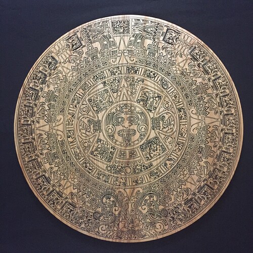

So I wanted to cut out a Mayan Calendar with my X-Carve to test out how detailed I could get it with a 1/32nd inch bit. I got everything set up fine in Easel up until I tried to get it to calculate the tool path and then everything just froze up. I tried this on both my shop computer and office computer with the same results. I then set it up in Cut2D and the same thing happened with Universal Gcode Sender. I broke up the project into 7 parts in Cut2D and then it worked fine. Has anyone else had similar issues? Here is the completed project. It is 24" and made from upcycled oak shelves.

This project was to test my new updates to the X-Carve and it handled wonderfully… just the software issue was a little frustrating.
Yours looks great!
The only material I had large enough at the time was a piece of 1/4 inch MDF and the amount of detail was really too much for the MDF to deal with so I lost a lot of the fine detail.
Thanks, I had some old oak shelves that a friend was throwing away so I made a larger panel and used that.
