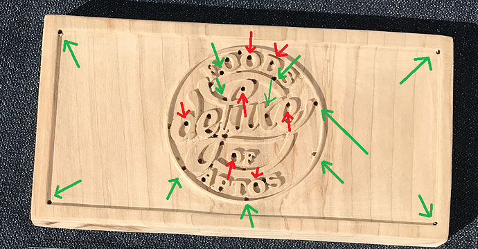

Very very cool! I noticed the little holes in your patterns, assuming they are for proper vacuum molding, do you pre determine their locations or do you attempt to vaccum then find out where you need them?
Pre determine. Once you fail at it for awhile you start to figure out where the mold needs to “breath”. Refer to the image below:
The GREEN arrows point to locations that are tight corners or places where the hot plastic has a hard time sitting flush with the mold positive. I basically think that the air will travel the place of least resistance first, so places like these (green arrows) I like to give a little extra suction power to help the plastic remove the air in that void. After a while I realized that the plastic will never actually sit flush to the bottom of the mold positive (except on large faces such as the border and the areas to the left and the right to the circle below). If you look at the pictures above of the molds, you may notice that you cant really see the holes in the positive. Thats because 90%+ of all right angles finish with small fillets.
The RED arrows indicate spots where there needs to be suction because the hot plastic will “plug” air flow. For example the letter “O”. The air in the inside of the letter has nowhere to go. The relief hole allows air to escape from these voids. I know that plastic will never reach the bottom of the void, but as long as it establishes a hard edge im happy.

So, is it safe to assume that you drill the hole with the xcarve ( since they’re pre determined)?
I actually drill those by hand. I may have misunderstood your original question. What I meant by pre-determined was that I know where the holes are going to be long before the carve is finished.
With that being said, I have ruined a couple wooden positives by ramming the chuck of the drill into a small delicate letter or something like that. So be careful haha
