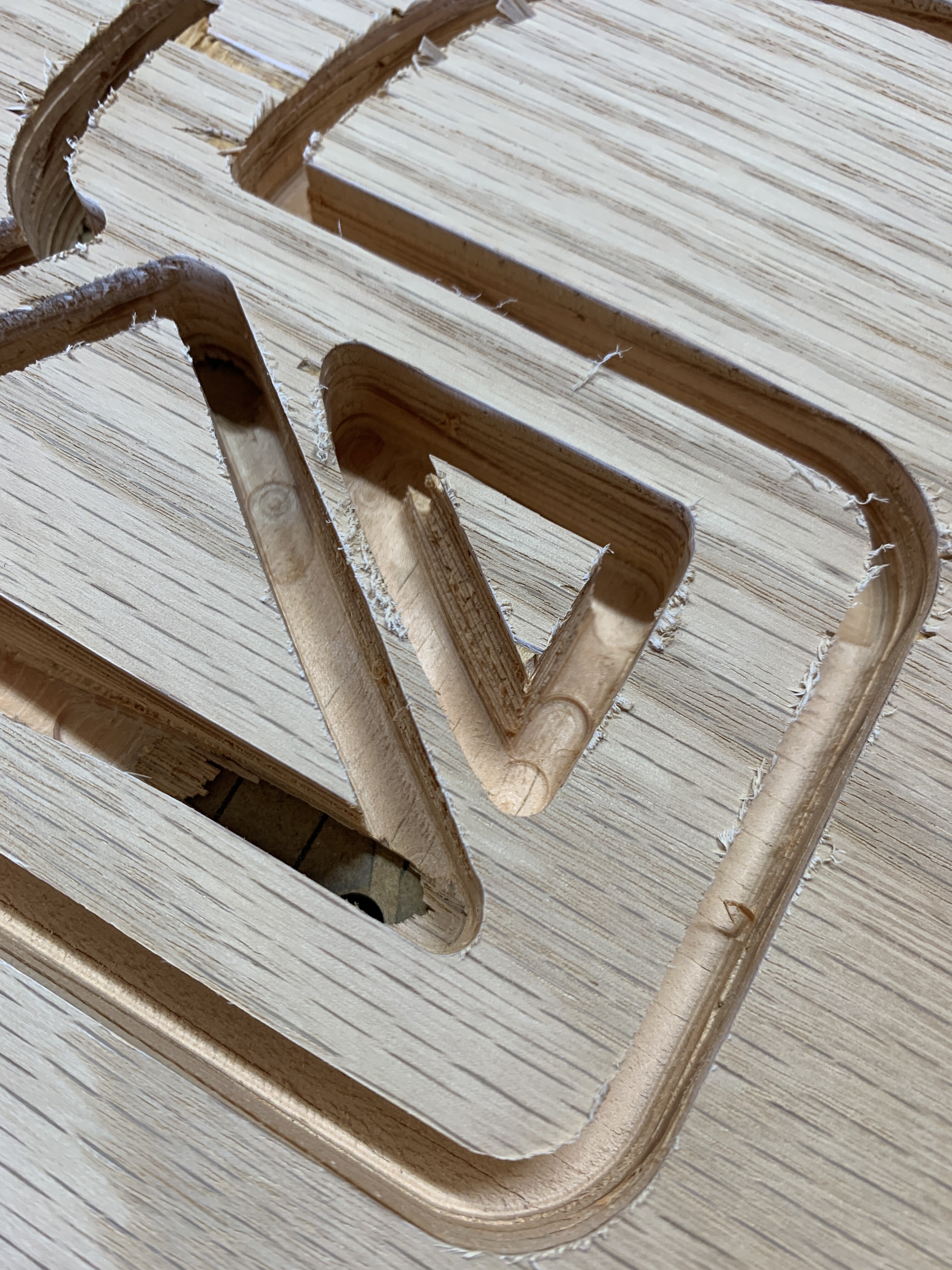

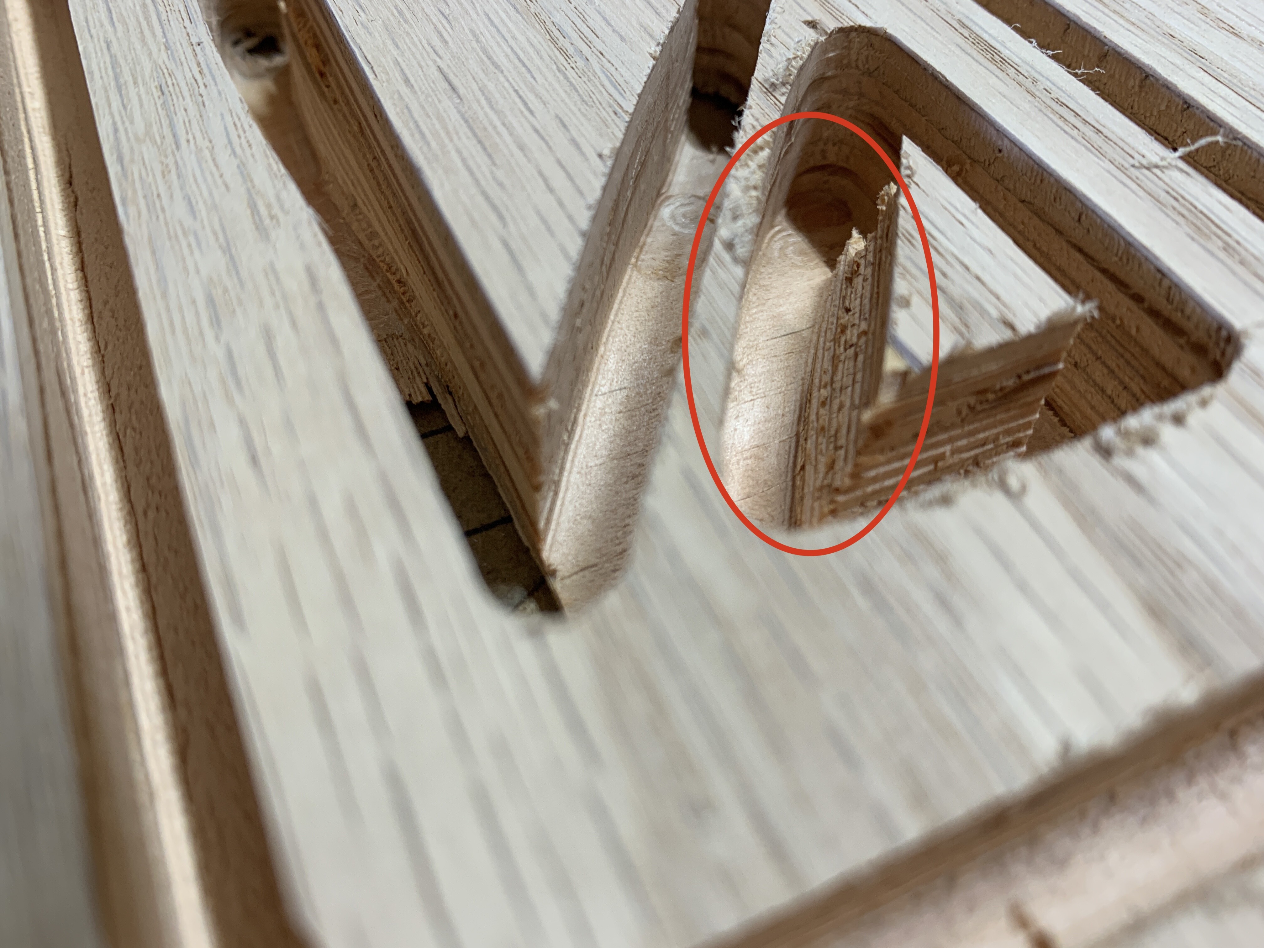

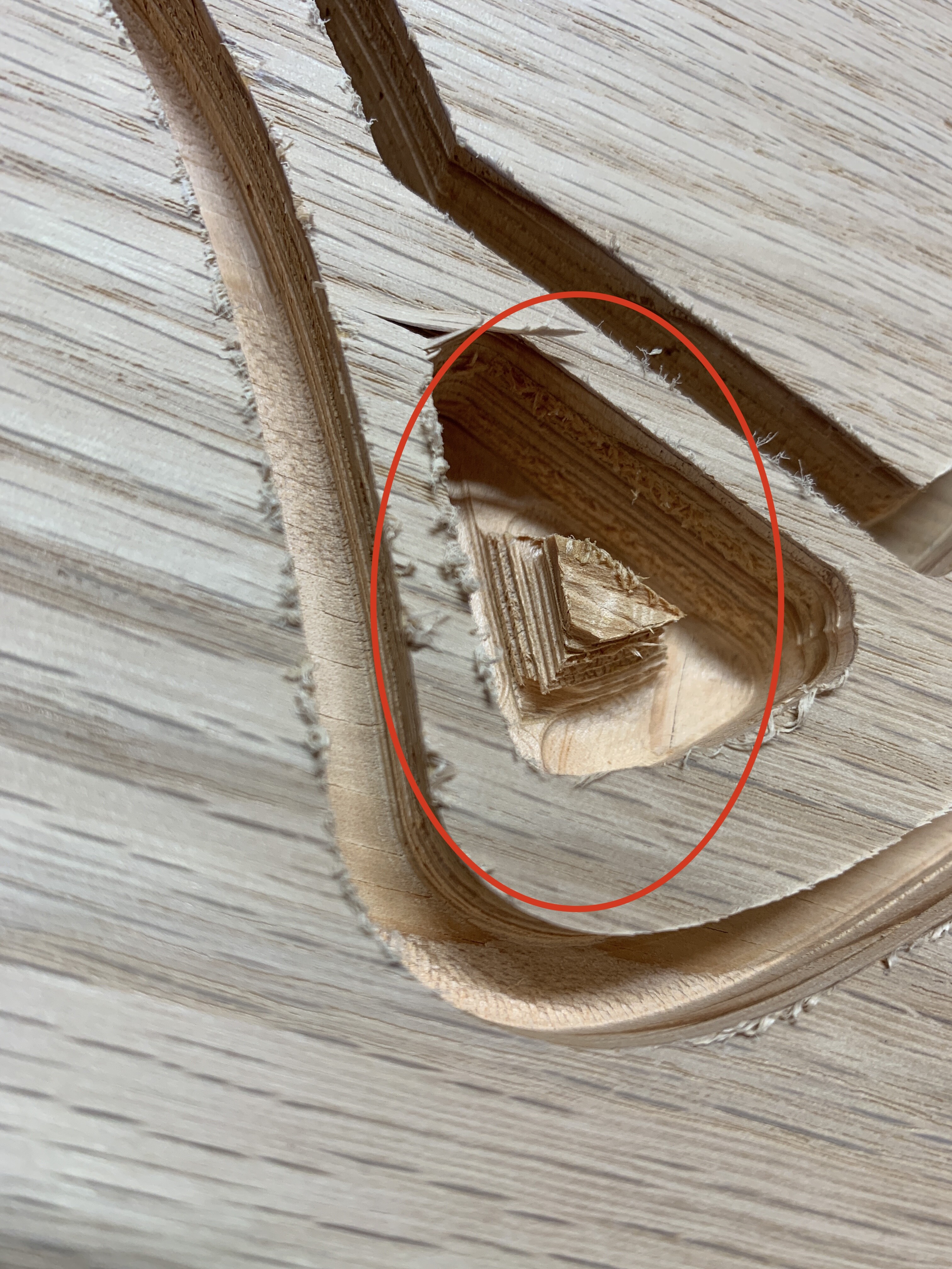

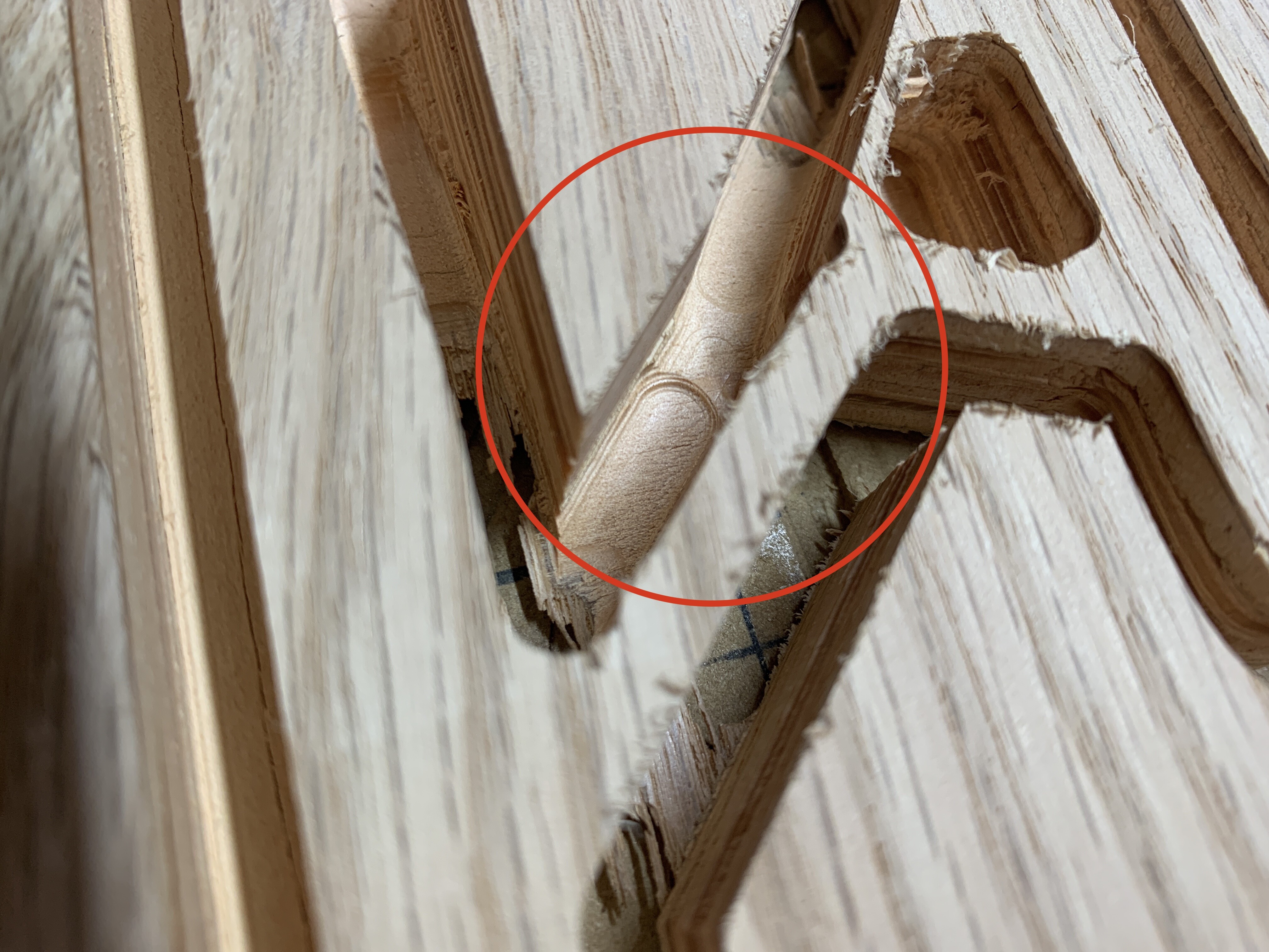

Chaps, carving something and I get this intermittent fault. On some parts of the carve you can see what I get from the images, other parts are perfectly carved, no problems. I have made this project many times, no issues
I have enclosed various flavours of the problem, they fall into two categories.
  1. Seems to be ramping unto the tab cut, yes I checked, no ramping selected.
  2. The tool goes off path. Interestingly, I checked to see if this was a random event, it happens at the same point on 3 test carves.

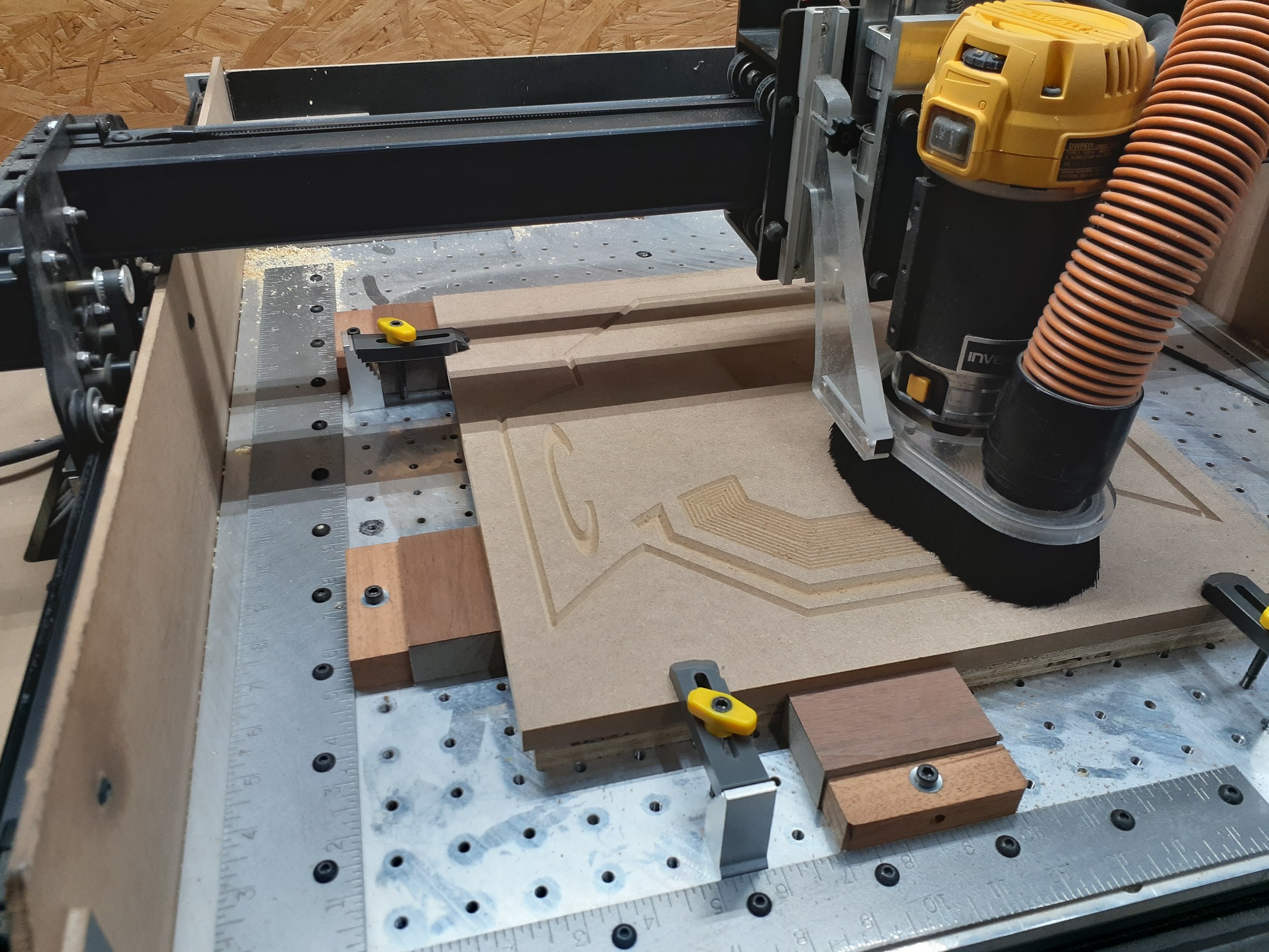

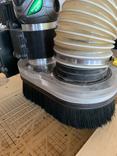

Eureka! I figured out the deflection… It was being caused by my dust boot! as the Z lowered, the brushes of the dust boot were put into compression perpendicular to the work piece, enough to deflect the carriage!!
I have a dead on, spotless machine now!!
What type of dust boot do you have, and why does it travel with the Z?
On my machine, I adjust the dust boot to just touch the top of the work and the router travels through it.
Never a problem.
Jan, I have one of these…over the last 4 years I have tinkered with many dust boots. I had the same one as you had but a catastrophe in the studio and It was ruined. I like what I have now, 100MM dust collection with a powerful cyclone separator.
Yeah, You somehow have to separate it from the Z axis.
Then your problem will go away.
