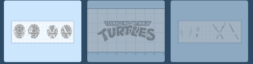

I have a project that requires cuts from two different bits. first bit 60 varve, second 1/32 fishtail DC. I carved my first part completely took 2.5 hours. I switched the bit out then re probed, then clicked previous XY point hit start and second part of the cut ended up being 3.5 inches out… Am i doing something wrong?

well i use two different carve boards you create. Im not sure if that’s the correct way or not but works fine.

Can you share the project that isn’t showing both bits? If the project is not working properly that’s one thing, If it’s not then I’ll make a short video and show the 2 bits toolpaths separately.
Go to Project>Share and change the project to “unlisted” and then copy that link… then I can see all of the project settings…

Well, I was actually asking Vanessa for her project, yours looked like it was setup well enough :grinning:
BUT since you provided the link and wanted my input, I made a little video of what I might change (mostly cause I knew I had a clean logo) . . .
Here is the video:
Here is the Easel Project: (I think I went too fast for easel to auto save to it was not letting me save at the end, so all of the bit settings of this project are not right, you’d want to set those up correctly for yours, but at least I was able to copy over the different design with the shallower depth for the shells, the combined parts, and my version of the TMNT logo)

Wow I never expected a 18 min tutorial, amazing. I learned a lot just from that.
Yeah for sure that was an image trace. I was trying to find a svg file of one but I just ended up with the image trace one. I Like what you did with the logo there. I will work with this. My end goal was to fill it in with epoxy that’s why I had it so deep in the shell part, I did get one shell done and filled with epoxy, thought it was a bit too deep so I will adjust some of those depths.
