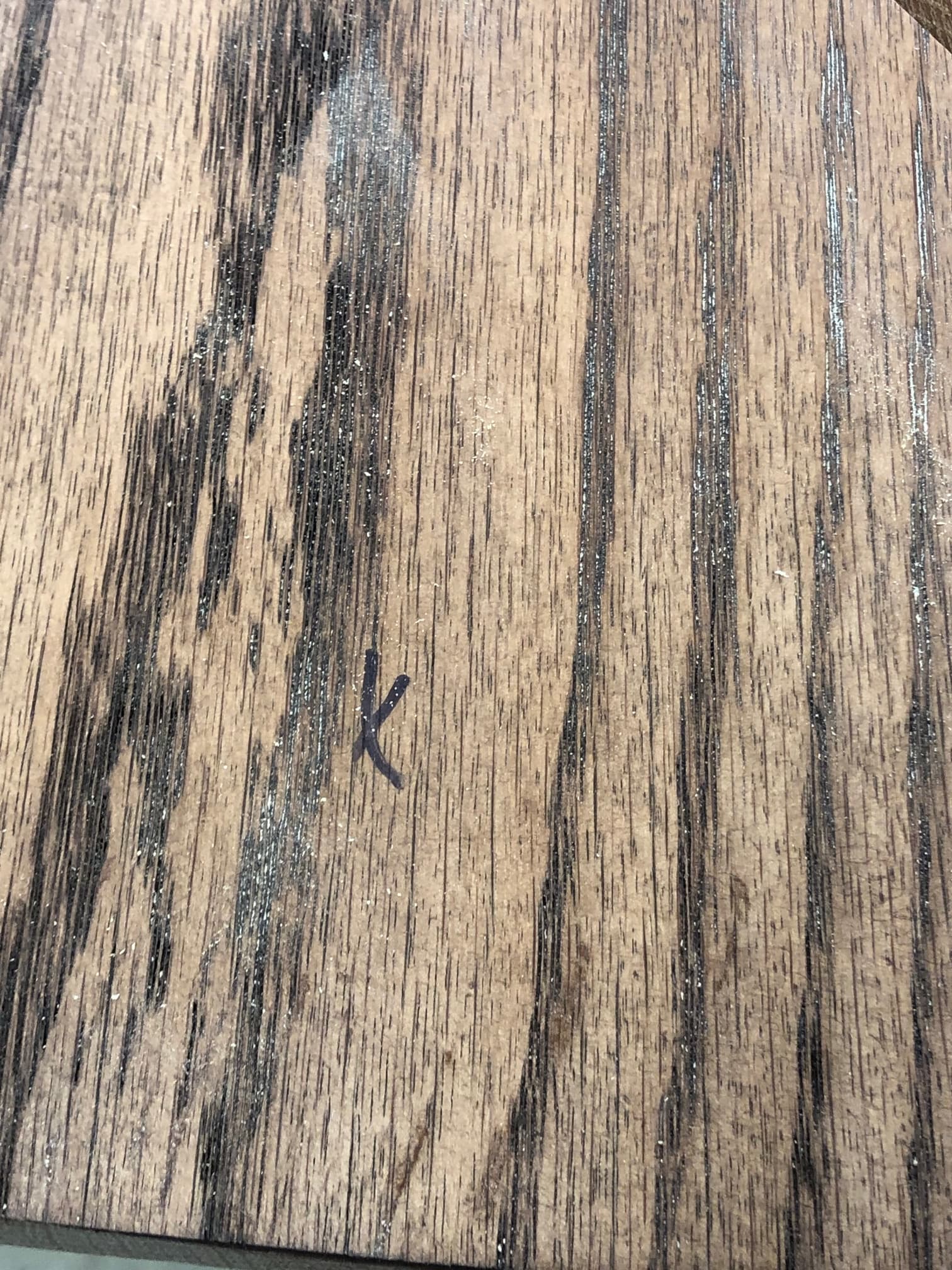

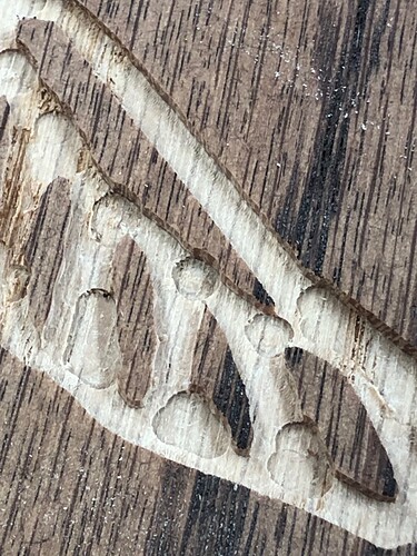

Issue #1: Different depth between rough pass and detail pass. I placed an “X” on a corner I knew wouldn’t be carved to set my Z axis. So I would be to be consistent between passes. There was a deeper cut with the rough pass (1/8" down cut bit) than the detail pass (1/16" down cut bit). This has not been an issue in the past.

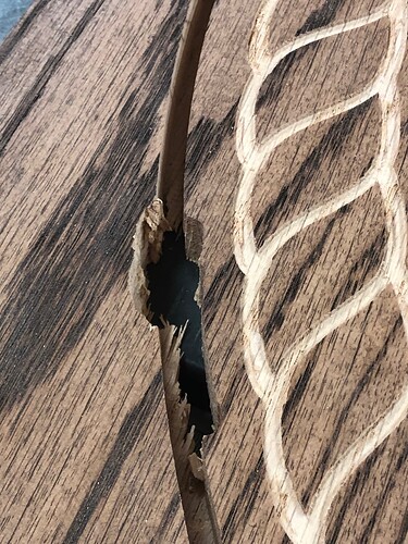

Issue #3: This happened a few times on the same type of carve.
I use a 1/4" down cut bit on red oak at 72 ipm. On the last or 2nd to last circle it grabs the piece and rips a large chunk out of it. This is usually when it has cut thru the piece and is cutting into the sacrificial piece below.
This doesn’t always happen.
thank you
down cut cutter works best, try a compression cutter for the cut out.

Also if it hasn’t been done yet, I suggest making this setting and dip switch change to the cnc to keep the steppers locked during the bit swap.
But also here’s the official 2 stage carving steps which would help to re-align the X,Y if the gantry does move during the bit swap. https://inventables.zendesk.com/hc/en-us/articles/360012453174-Two-Stage-Carves-Roughing-and-Detail-Carves-
another thing to be cognizant of is the Z axis possibly bottoming out. It doesn’t look to be the case with this particular carve, but if you were to use shorter bits or thinner stock, this issue could come into play and it’s good to know about it…
