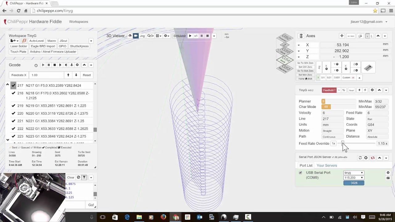

The latest version of SPJS (version 1.85 as of this post) is now in Github and supports feedrate override during the middle of a job. There are no compiled versions yet made available so you’ll have to compile on your own and there are no GUI elements added to ChiliPeppr yet to let you easily do it, but you can control it from the console in ChiliPeppr in the middle of your job.
Keep in mind that this only adjust the gcode as SPJS sends it up to the controller (whether it be Grbl or TinyG) and each controller has its own buffer. So, those lines in the controller’s buffer have to complete their processing before you see the effect of your feedrate override change. In practice this could take 5 to 10 seconds depending on your Gcode.
Here’s the section in the readme that describes it a bit further

Just launched this morning. The new Feed Rate Override in ChiliPeppr. See bottom row of screenshot below.
I published a video this morning showing how it works.
