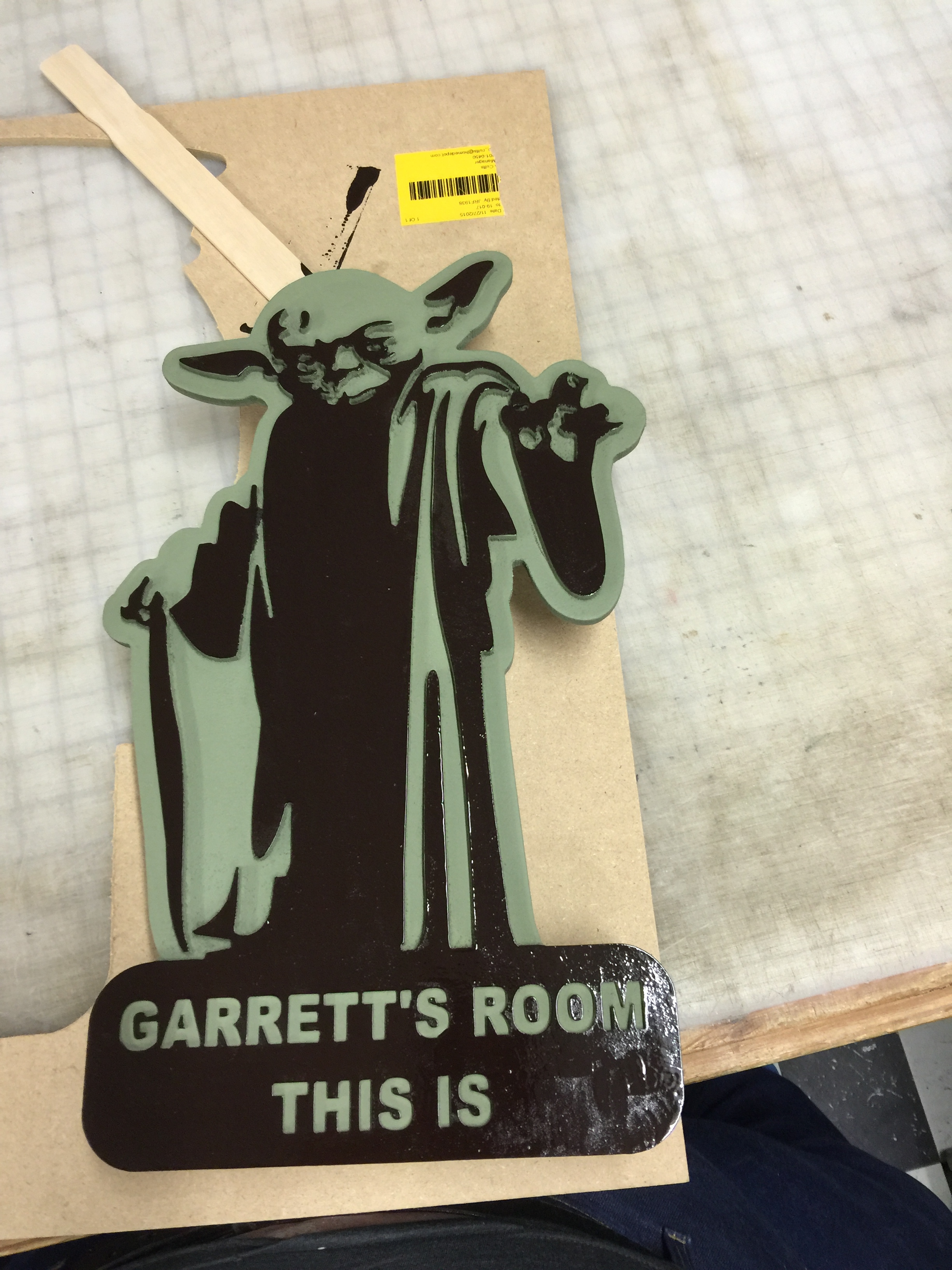

Here are a couple of the Christmas gifts I made recently.

I made one for my cousin and one for my nephew. They both loved them. The picture is of the first one I did, the second one turned out better but I forgot to take a picture of it. If you’re interested I will share Easel file.
Looks Really nice, how did you get the paint lines so exact? Did you tape it and then cut it out?
No I sealed it then painted the entire thing moss green. I then brushed the brown on very carefully. By the time I finished the second one I had it figured out. If you start your brush in the middle of the area and pull it toward the edge going past it it will leave a clean edge. If you start at the edge and go inward the paint will run down the edge. Afterwards I just touched up any errors with some moss green. I then cleared the entire thing.
