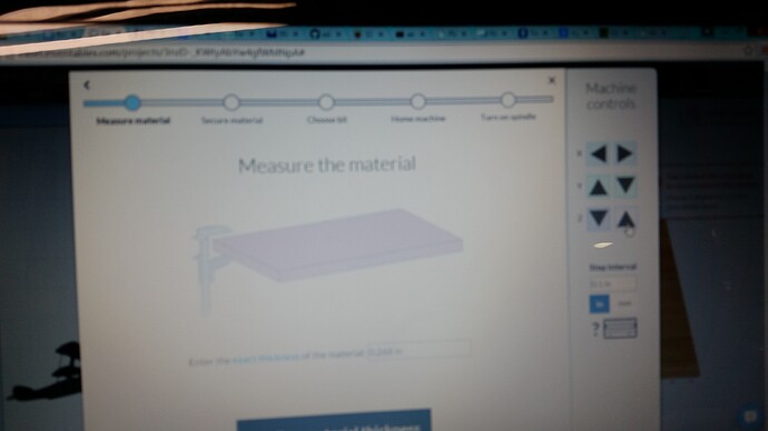

This is what I
see
Then you just enter the number of mm into the box (be sure the mm check box is selected) then click the Z up or down movement button.
There is no boxes
Yes there is. It says step interval right over it.
Ok now I write 70 mm from zero and push up to z axis it’s go about 20 mm and stop
I give this nub er to x and y they go 70 mm

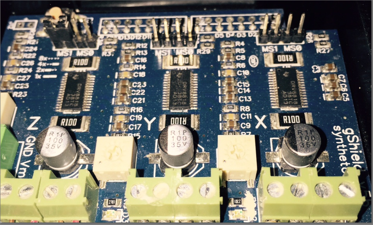

Maybe the problem in the z control, how to configure the current or steps , maybe the jumpers was changed

If you have a photo of the controller and jumpers in that control, if I change current flow through zaxis

i did that many time , i open the driver and i see a jumper in drive z , it is changed , i have four pins, and the jumper connect to two pins, i want to know which two pins isto connect because i see the jumpers moved when i assemble the driver with ardunio.
thanks Allen for your help , i get it, it was a jumper moveved , i open the driver and see what happened to the z axes, i see that the jumper was not connect , i connect the jumper in the writeplace , i run the test, now is very good,thanks again for your help.

Just in case anyone else has a jumper problem here is what the jumpers on the gshield should look like
Jumper over left two pins for Z, no jumpers on X and Y
