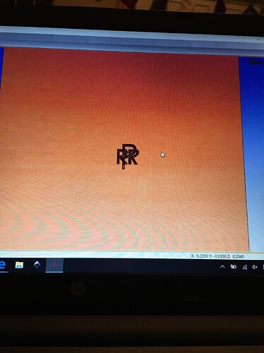

hi everyone. Just having a little trouble trying to make a Pennsylvania railroad and just wondering how I’d fix this so it looks fluid when I perform outline. I’ve been working on this and wondering if headed in the right direction. When I click on outline it seperates.

I am working on it now. I will explain it with some screenshots.

  1. I imported the graphic via the bitmap import.
  2. I then cut out the areas I didn’t want using white shapes and combine. The white shapes must be brought to front so they cover the part you want to remove.
  3. I then used black shapes to put the lines in so its continuous
    Now All that is left is to figure out where you want to add bits to keep it together or you can set heights in between.
I would have made it so you can cut most of it deep cept the parts you want to look more raised than the rest.
