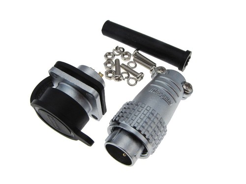

This Is a idea I have been toying with. I was going to do as you said and relocate switches to a empty bay panel and use aviation connectors to connect to the xcarve.
Aviation connectors would definitely be the way to go. I’d even like to make a cute little connector panel to fit in the existing PCI slots out the back of the case.
many kinds to choose from
