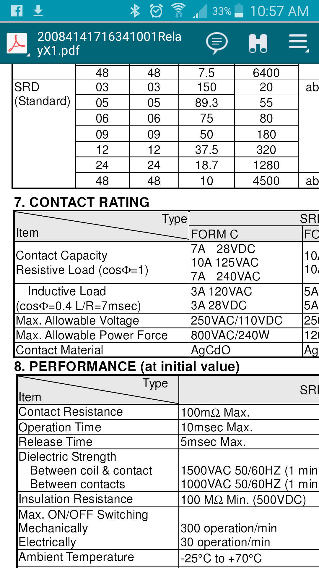

Two issues with this relay. First is the load capacity. The DeWalt pulls 7 amps running and more during in rush. I wouldn’t want to run those relays that hard.
The other issue is that grbl uses positive logic (High = 5 volts, Low = 0). The inputs to the relay want negative logic (On = 0 volts, Off = 5 volts).
Grbl is capable of doing that, but it is a compile time option.

Well, poop. I misread the specs on it. I saw it could handle 10 Amps, but my brain saw 120V, not 250. So, you’re right - it wouldn’t run the router.

It can handle 10 amps at 120 VAC. It’s the 10 amps that bothers me. You can run it with 7 amps. My concern is that the in-rush currents are likely to exceed 10 amps for a short period of time and that will shorten the useful life of the relay.
It also handles 10 amps at 250 VAC.
I would agree in a commercial setting, but in a hobby setting he will be fine,
Plus he has a second relay to use, if the first one fails! Just Kidding. But seriously…
I mention this because without looking a data sheets, MTBF (mean time between failures), etc… A statement about a in-rush currents, and “short periods” of time are very SUBJECTIVE.
Additionally, the Dewalt 611 specifically has a soft start feature. So if someone has measured the in-rush current and can prove that it is even significant it would be great for the forum to see that.

I pulled the datasheet and it’s only rated 3A 125 vac with an inductive load

Honestly, a newer logic level HIGH relay board might be your easiest solution, but as far as current is concerned, 10 A is still okay.
As pointed out, inductive and resistive loads are tricky electrical topics (Power Factor stuff).
Again, I don’t think any one has measured the Power Factor for the DW611, but I doubt it is anywhere close to by 0.4 (my subjective opinion).
