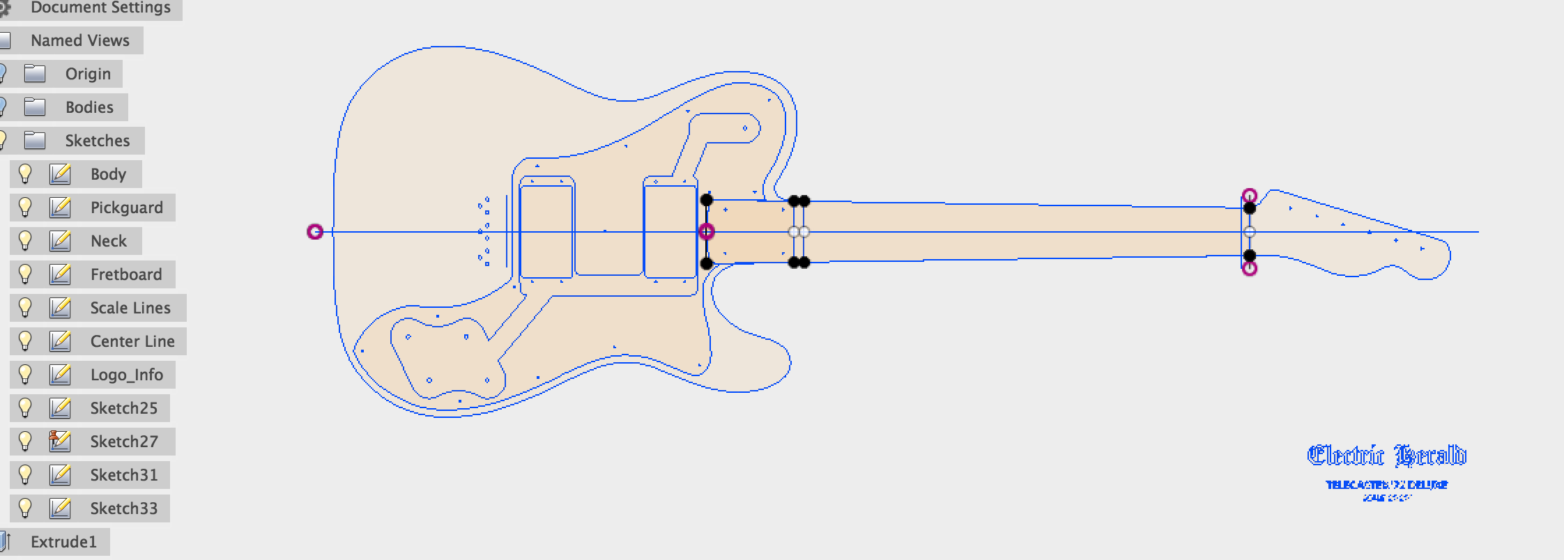

I have a Telecaster Deluxe model extruded but I haven’t gotten around to finishing it.
Luckily, teles are so damn simple and ubiquitous - here’s one from GrabCAD that uses the standard cavity routes. Really, GrabCAD may be your friend here.
This is the '72 deluxe model I was diddling with - as you can see, I haven’t gotten around to putting a headstock on it. You’re welcome to it though if you like:
The cavity routes are not standard on this version though:
