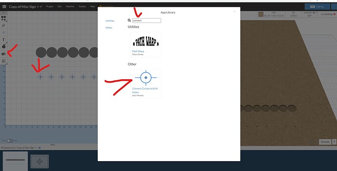

Convert circles to Drill will take any circle shape, and assign the drill function to the center, so no matter how large or small the the hole, the current bit will plunge straight down. right in the center… my photo shows using it on a larger circle, but it works just the same in your case, with the hole too small for the bit…

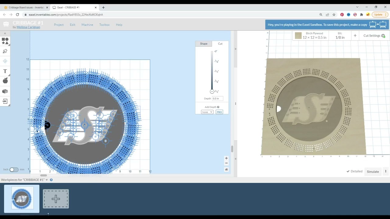

I noticed that there were extra drills and then also noticed the circles still remaining under the drills. . . this is how I would do the circles to drills as well as separate out the carve into multiple workpieces for more bit control.
