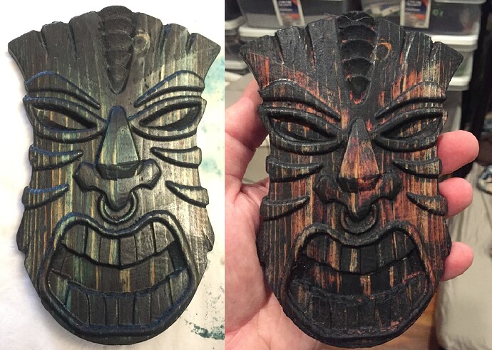

I have been playing around with mixing some of my so strong pigments from smooth-on into various finishes to create custom color stains. With some pleasing results.
But some of the finish pieces would change color after a few days and I was not sure why.
Well I think I figured some of it out.
Here is a good example:
The color was stable well over a week until I left it, in the sun, in the front seat of my car. After only a couple of hours it changed from green / yellow to green-black / orange
Originally I was thinking it was chemical reaction in the pigment. But being that this particular one was so stable until exposed to sunlight (presumably the UV). These same pigments do no exhibit this effect when used with silicone or polyurethane resins (which is what they are made for)
What I find interesting is the “natural” wood seems to be darkening as well. I am thinking it may be something happening in the tung oil finish or paste wax coat I am putting on top?
Maybe they are “Yellowing” causing the change in tint?
I will try to run some tests and see if I can track down which elements are having the UV issues.
Anyone have any experience with this kind of thing? Or know a source for premade colored stains?
I really like being able to create my own color effects, but I need them to be stable.

Thinking back on it some of the projects I stained with minwax Sedona Red and toped with paste wax also darkened significantly.
I suspect that the paste wax may be a major factor. I will try to make up some test swatches of different combinations and see what happens

I kind of like how it looks after being exposed to the light, it looks like and old carving.
