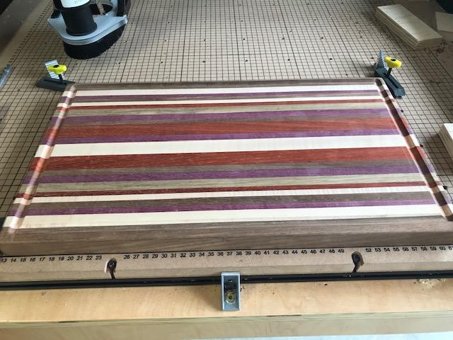

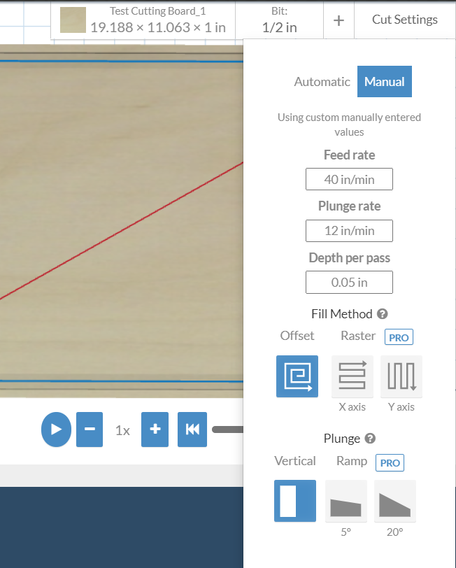

Good day everyone. So i have been working on fine tuning the settings in order to cut juice grooves in my cutting boards and butcher blocks. I have included the settings that i used for this test run however each side is off from the image within Easel Pro. Within Easel Pro all the dimensions everything lines up perfectly with a 1/2 inch boarder all the way around. I added details of the measurements and the final results of the finished work. I am super green to the CNC world and would greatly appreciate it if someone can provide guidance on what i missed or possible root causes that is making my finished product off so much.

Thank you Seth for the insight. I had figured that the calibration is off but i also believe now (after checking the belts) that i need to tighten them up. I have a link that was sent to me that has a short video on how to use the formula to correct the calibration issues. Once i have those entered in i will run another test run to see if it is good to go or not. You had mentioned that it better to use the center of the project as the 0,0 (X,Y) which i wanted to try before hand (had a couple of mess ups using that setup ) but I’ll try it for the cutting board tests.
The project was secured firmly to the waste board (picture was after i had removed the clamps) but i will try the other option once i can buy\make them.
