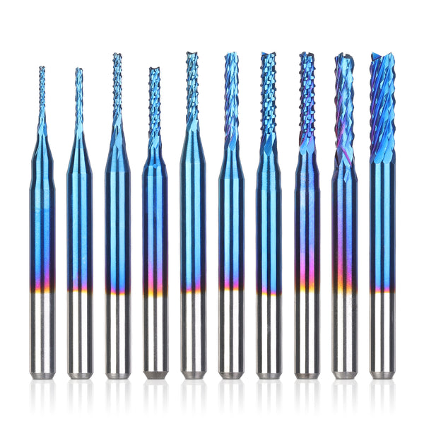

I’m new to the CNC machine and I’m really ready to throw this machine out the window lol. I’ve been working with this machine for almost 3 weeks now and I feel like I’m not closer to achieving what I set out to do, then I was 3 weeks ago. Can someone (anyone) help me with cutting out letters. I have Genmitsu Pro 3018 with a 24v motor. I’ve tried “cutting on” “cutting outside” “cutting inside” and i’ve broken 4 of my CNC Router Bits, with no success!!! I’m cutting on a 2mm acrylic cast sheet, with 1.6, 1.8, 2.0, 2.2 and I’ve managed to break all of them. I’m so confused about setting the correct settings from “Depth Size” “Feed Speed” PLEASE HELP ME!!! I’ll take and appreciate any assistance from anyone…Thank you in advance!

Do you use these bits? If so these are “burr bits” and totally unsuitable for plastics.
Acrylic will melt if the RPM is too high, feed rate too low or bit is not able carve “chips” - it will begin to melt and all bets are off. I think this is what you experience.
Yes that’s the exact set of bits that I have. So are saying that these bits are no good for cutting letters in acrylic?

No good at all. Burr bits dont make chips so the acrylic heat, then melts and create havoc for the bit. Burr bits are for materials like FR4 glassfiber boards like PCB´s.
You need a single flute upcut bit.
Amana makes bits specifically for cutting plastics. I have had great success with them.
