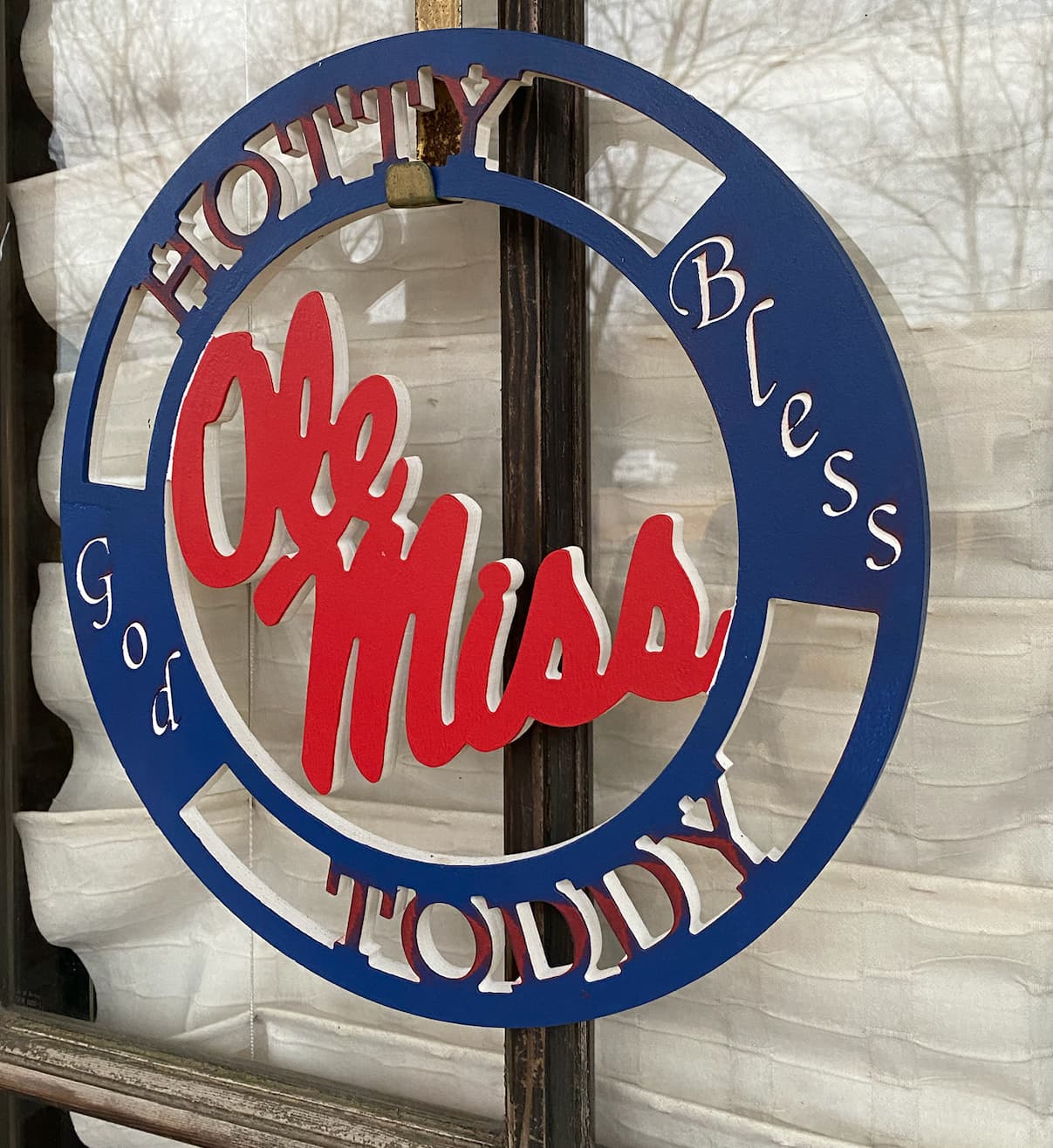

I am having the hardest time figuring this one out. I need to make a door hanger similar to the one in this picture, but I can’t for the life of me figure out how to cut AROUND my image to make everything stay on the sign and just remove the wood in the negative space.
ANY help and tips will be greatly appreciated!!

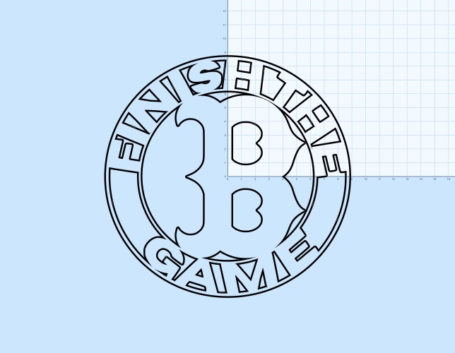

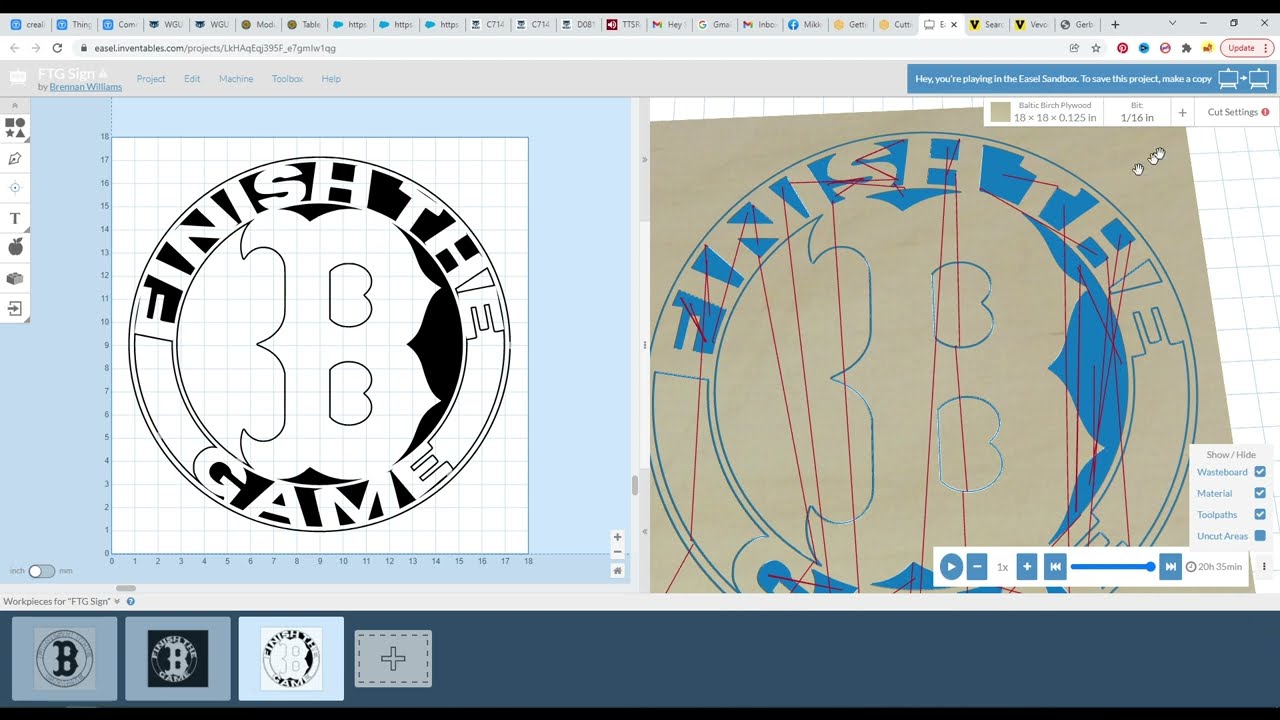

That’s exactly what I have done with the text. However, I cannot get the circles to work for me. Here is the link to my Easel project that I have started. It’s going to be on a circular piece of wood.
