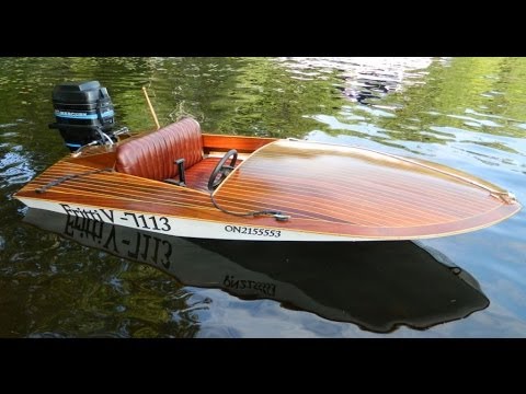

Second, I’m not sure I’m going to pursue it because just about the only thing it can do that the XC can’t is carve out boat parts from a 4’ x 8’ sheet of plywood (which is something I’m very interested in).
With that being said, I do have several boat plans as DXF files that I would be very interested in making and lofting and cutting out the boat parts is at least 20% of the build process. For example, one 8’ boat if carved at a 2:1 ratio can be a very 4’ cool coffee table or baby cradle…

With regards to the 4x8 sheets of plywood issue, I can pass more than a half sheet through with proper tiling and very few boat parts take more than half a sheet to develop the curved hull form.
