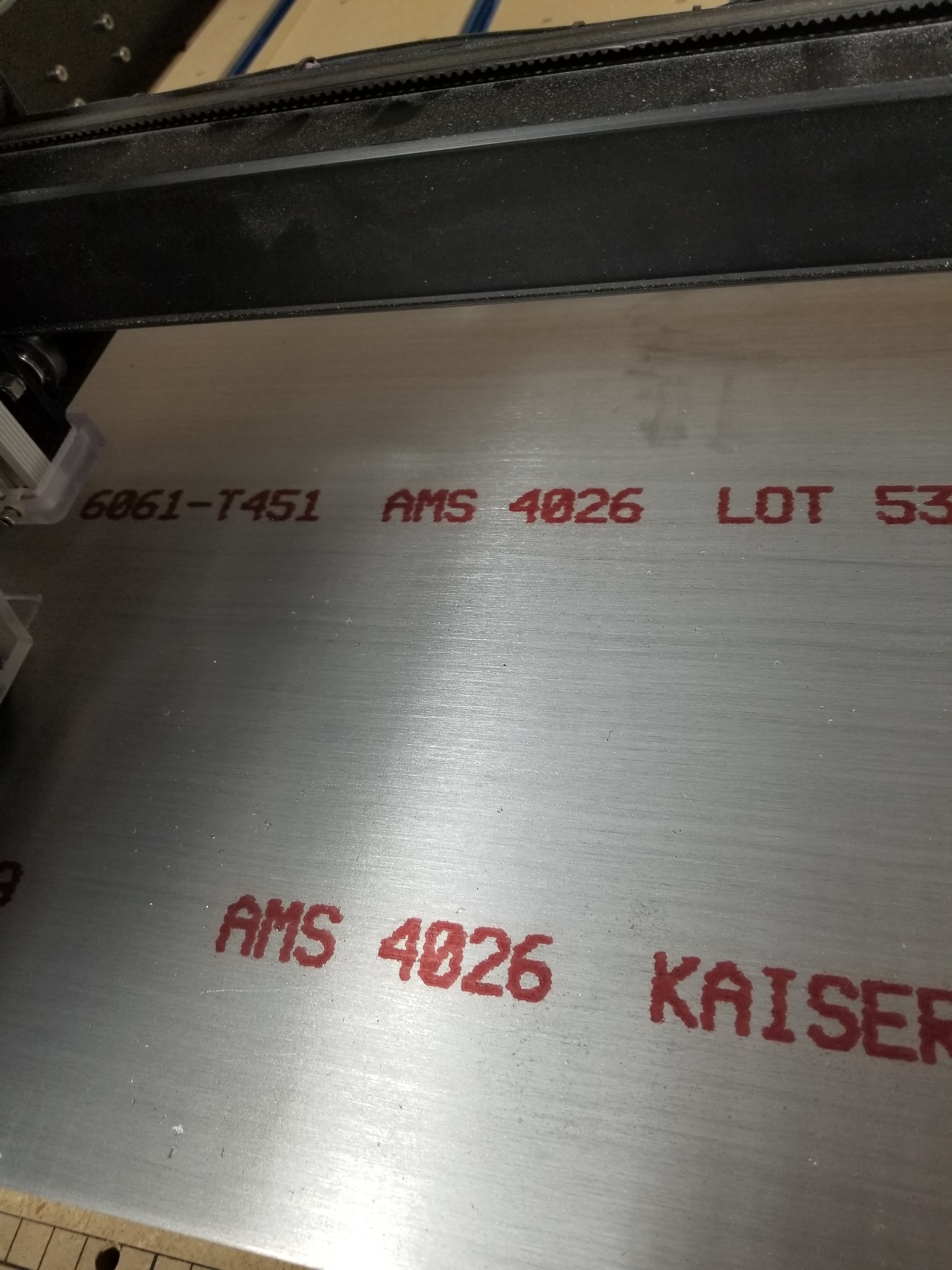

Some fun with aluminium now. Wanting to do some riser plates so I was playing with some 6061-T6. I have this .125 sheet from inventables and 4 24x24 sheets of .25 from when I was doing the bigger printer in my build log. Cut a couple of gears out to give it a test. Figured the boy would like some to play with(he did, and he does lol).
I was conservative I think with the feeds/speeds, There’s so much info for aluminium on a semi rigid machine that I felt it was best to just go for it and try and hope I don’t break a $30 bit. Here are the results. Finish was good, minus the adhesive it brought up from the blue tape. I didn’t want to use tabs or clamps. (I’ll take any good tips on cleaning bits btw). I used a 1/8 spiral 0-flute aluminium bit from Amana. Feeds/speeds: .004 DoC, 10ipm P, 30ipm F. I feel like there’s quite a few ways to set feeds here if anyone has much experience with aluminium, I’d love to have some conversation around it.
Edit: I post my feeds/speeds for a few purposes, for those that choose to use any feeds/speeds I post, please know my machine is modified with cnc4newbie Z, 9mm belts, and 270oz motors.
Aside from the adhesive that was brought up by the tape, the finish on the cut was smooth and clean.

Went ahead and skimmed the new waste board. I should of done it first thing but… fun…
I am happy that I spent as much time as I did tramming this in the beginning while building. Makes for a smooth skim.
Went ahead and started cutting on these sheets of 6061I have. Figured there was no point in waiting to do the riser plates.

I have it running at 33ipm. I still feel it’s conservative but I’m ok with it for now. The chips coming off average .002in which is within the spec of the speed/feed chart from Amana for this bit. I think it was .002-.005 for this particular bit. Still, I’ll leave it at this for now and run some tests at some point in the 1/8 sheet I have.

Of course! The angles speak to me so I had to lol. Here’s the finished product.
Sanded all faces with 120/220 to clean and keep the brushed look. The first 3 were cut at 30ipm, the 4th is where I played with the speeds a bit. I just kept bumping it up every few layers until I had chatter. At 200%(60ipm) there was still no chatter so that is pleasing. It’s not a very deep DoC though so it could probably go a bit more before I see any.
