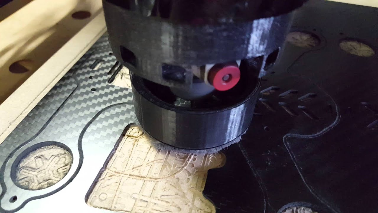

Day 2 running my new X-Controller
So far I’m liking the new x-controller. I felt it has more power compare to stock andruino/grbl shield. Usually on my old controller after few cuts on carbon fiber, it start showing some slight curving on straight line and I need to replace new sharper bit. But with the x-controller, I’ve been cutting couple of sheets now on same bit and the cut quality are still good.
Also the build pause/resume is freaking excellent. I use it couple of times to remove some big pieces that was suck on my dust shoe. Built-in emergency stop and much nicer port wiring.
By the way I’m still using single Y axis connectint cause it’s the most easiest route without rewiring my xcarve. I just simple put the pot to the highest value for Y axis.

May I ask you a question about installing the new controller. When I first turned it on computer recognized a new device. To install the new driver, do u install it under the arduino file?
I didn’t do anything on my side. It works fine on mine although I noticed its running on different COM port.
Well I got it going. Had to install new driver under arduino folder. Changed my com port as well. I like your set up by the way. Been thinking of doing a vacuum port similar to that
What kind of bit are you using? Diamond cut?
Yes. 1.5mm
What kind of spindle are you using and how are you controlling it automatically? A relay of some sort?
Also, what software are you controlling the X-Carve with?
Please see my first post. I upgraded the list of upgrades for my XCarve
