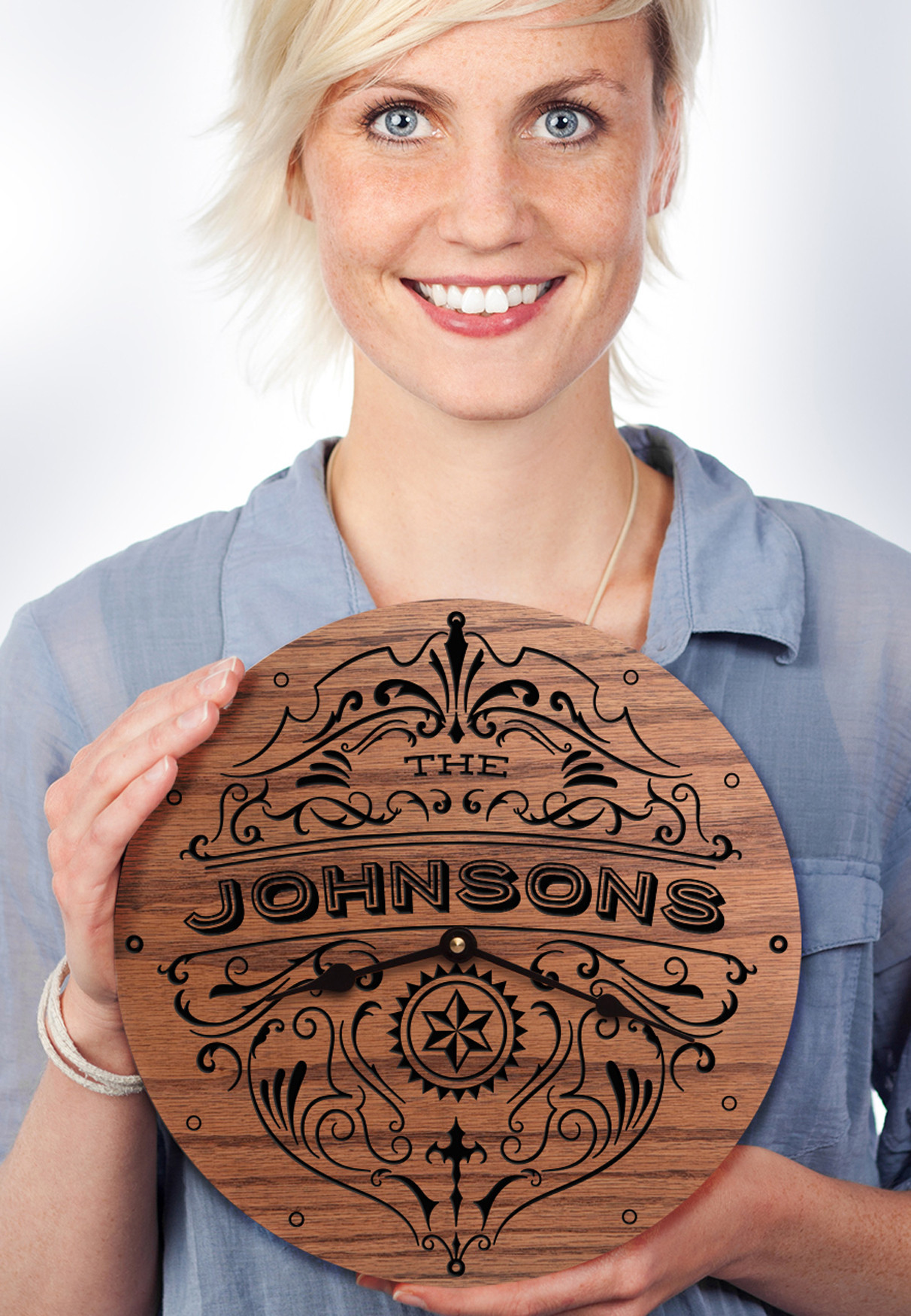

Hmm seems to me that you could cut the pocket down .075" and then go back and engrave the lettering down .040-.060" with a tool like this it will give you sharp fine detailed lettering with one mill
Thats how I make these
Cool! What kind of bit is that? I’m still pretty new to this stuff
its called and Engraving tool
This is the tool that I use to engrave the clocks it uses insert tooling but is basically the same as pictured above]
they make different tip cutting widths for different size letters
