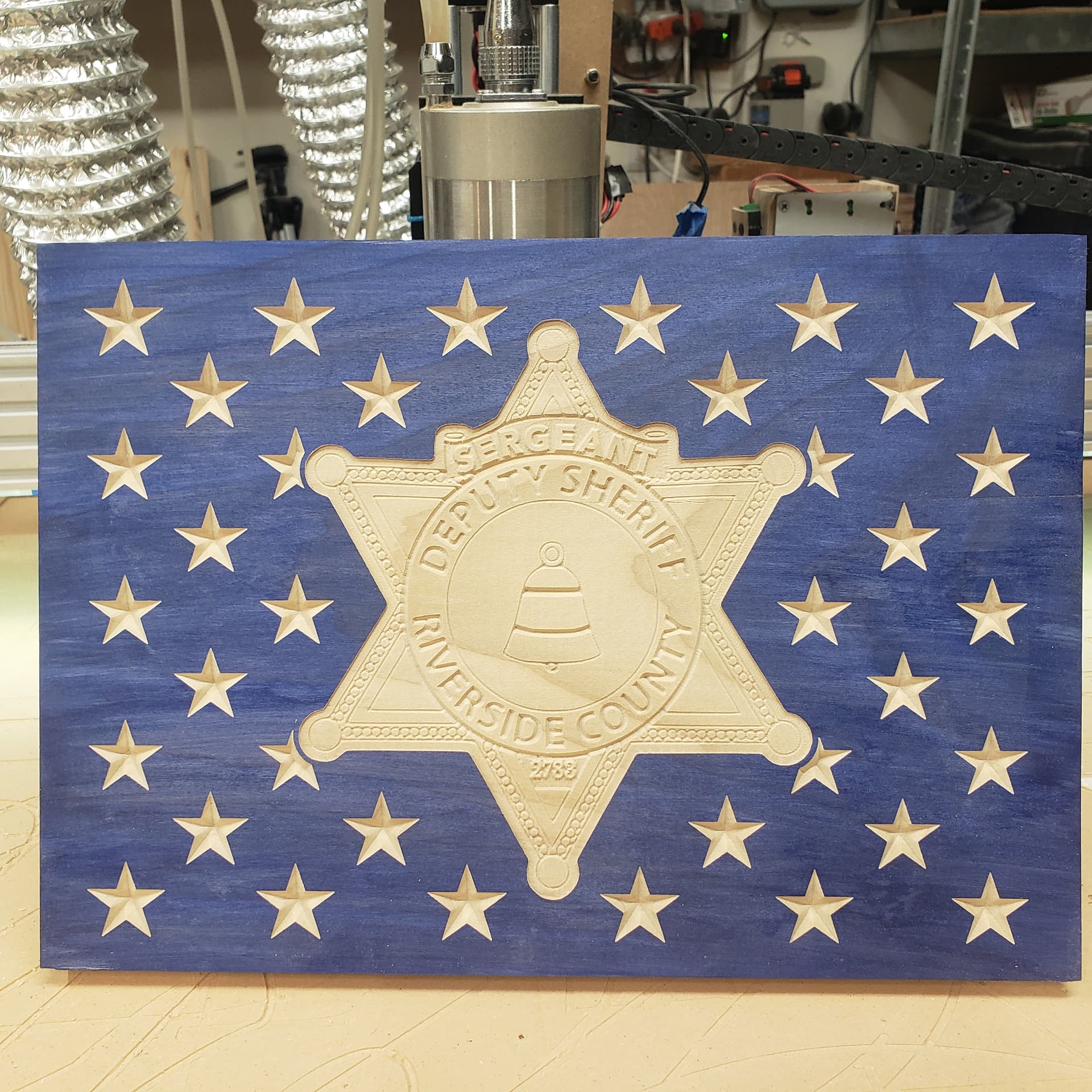

You would probably do better with a 90 or 60 degree V bit. You can run a V bit faster than you can a 1/16" bit and the carve will look good.
You will need Easel Pro to use a V bit.
Yes you’re 1/8" bit is to big to carve anything so you will be doing the whole carve with the 1/16"

Your times are split like that because the majority of your design will only fit the smaller bit… these types of designs are typically done with a vbit, not tiny endmills… try a vbit in there I like the looks of a 90 degree. But a 60 degree would also work…
You might also want to use 2 workpieces and use the 2nd one to cutout the perimeter using and an end, if you did want a cutout badge shape… heres how I do the multi workpiece setup for better control of what bit is used in different sections… same concept for the perimeter being cut with a different bit.
