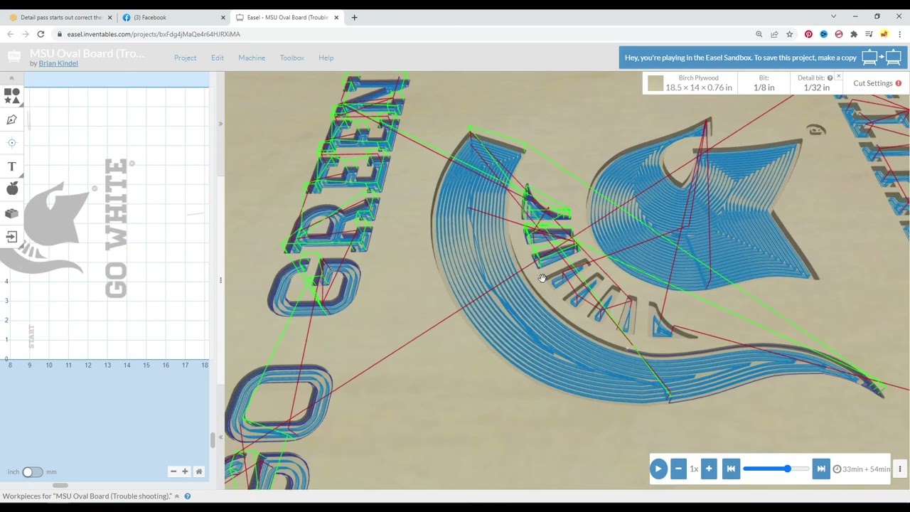

Hi everyone. I’ve been using my X-Carve 1000 for over 3 years and have had pretty good luck, but I am experiencing something new.
I make a lot of cribbage boards and I make the cuts in several stages. After cutting the pegging holes, I cut an MSU design in the center of the board using both roughing and detail passes.
I’m carving into red oak, using a Birch Plywood for the material and no changes to feed or speed.
The roughing cut uses a 1/8” double fluted straight cut end mill and the detail bit uses a 1/32” fishtail spiral bit.
Between each carve, I home the machine (using the stops for X and Y), change the bit and re-zero the Z with the probe.
When starting the detail pass, I pause the machine as it lowers to begin the carve and ensure that it is in the correct position, then un-pause the carve and let it begin.
The first part of the detailed looks great, but then it starts to very slightly off path (negative on the Y axis).
I’ll try to attach a photo so you can see the result.

Again, looking at the cuts, the words GO GREEN are just what I wanted, but by the time the carve gets to GO WHITE, I’m off by 1/16" so, something is not working right.
Ok, so no material. By logic, it is not the bit change. That would add a constant XY offset.
What I am thinking is that your two Y-axes (Y1 and Y2) don’t move together. So one of them is behind the other (say Y1 moves 10 mm, Y2 moves only 9.5 mm) which causes a tilt and that causes a changing offset. Check the belts, make a mark, then move Y like 500 mm and measure the distances travelled by both axes. Do it like 5 times. Even if off 1 mm, that will cause this. It can be that something gets under the gears maybe that causing one of them to slip… or one of them just became loose? Maybe too tight?
I see what you mean there. It could have skipped a tooth, but woth that tiny bit id expect the bit to break b4 the belt skips… unless theres some small part (like the little lines) that drive the machine left just a tad further than its can travel, and that makes it loose a steps, after the go green is carved…
Can you share the easel project?
Go to project>share > change it to unlisted and copy that link… we can’t mess up your original copy via the link

I am starting to think that it might simply be the material (feed and speed), or the 1/32" bit.
So, I am am going to try using a 1/16" bit instead next time.
