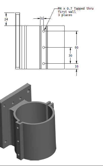

You know those little threaded holes on the Dewalt spindle mount, opposite the side where you tighten the mount around the spindle? What is the screw size needed to attach stuff over there?
Thanks!
