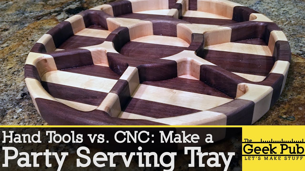

Finally, I personally find designs that hog out lots of material to be wasteful of both time and materials and I instead prefer designs that achieve similar results through gluing up cut pieces. It might be possible to cut many pieces of this project on the X Carve before gluing them up and doing final finishing. It might be interesting to do alternating slices of contrasting woods the way some cutting boards are made.

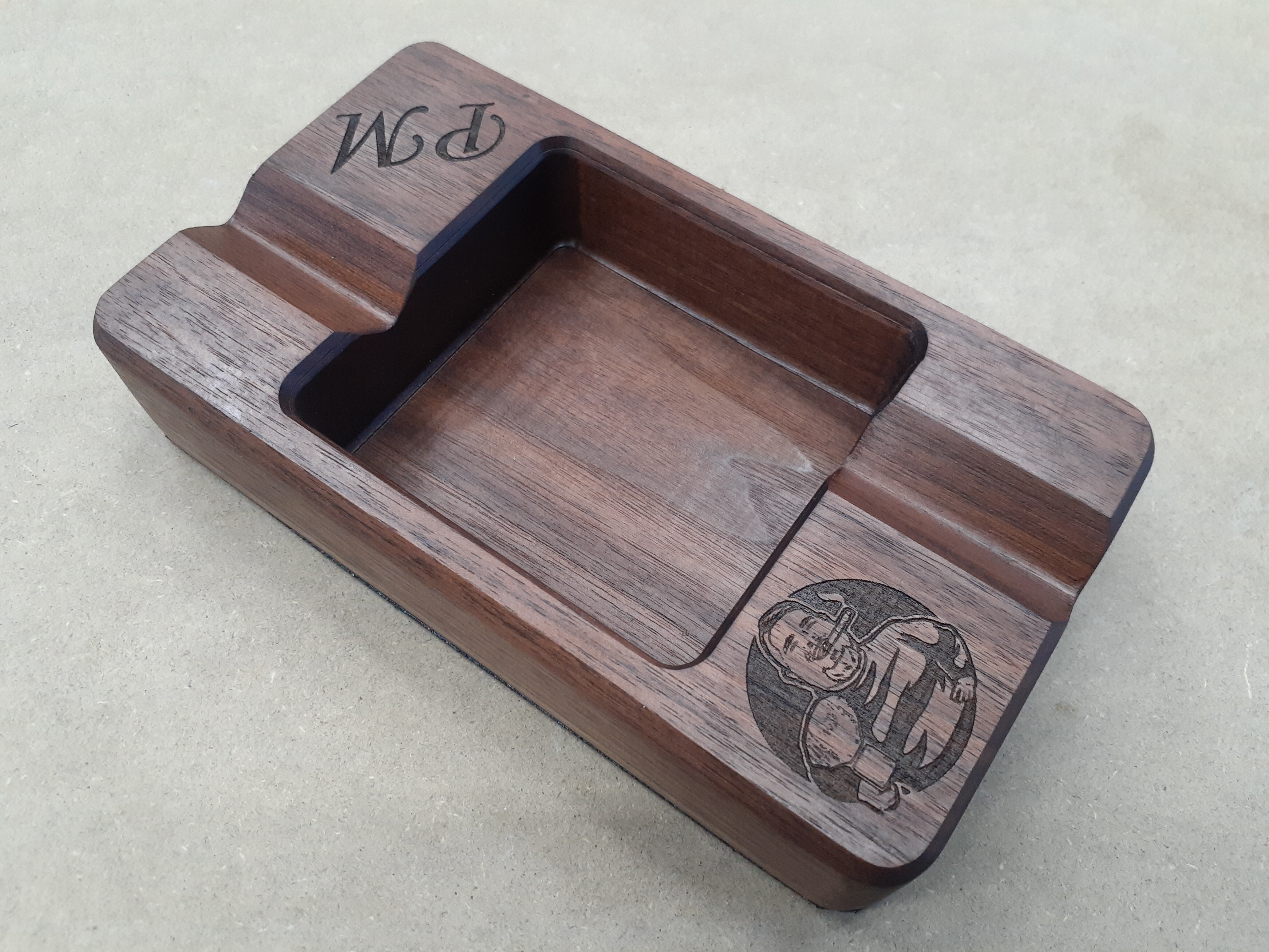

I know it can be done as I make cigar ashtrays all the time.
Hope this helps you out.
