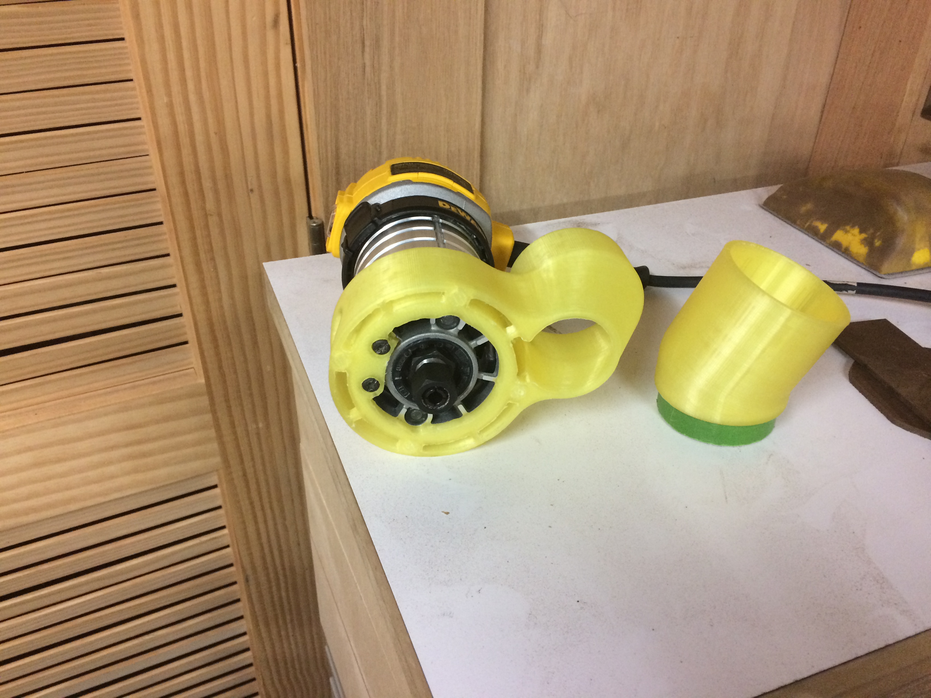

Just finished installing my new 3D-Printed Dust Shoe on my Dewalt 611. Seems to be working flawlessly.
I did have to keep trimming the bristles up until they are above the cutting length of the 1/32” bit that is in place. I could see the Carriage and the Z axis flex due to the stiffness of the bristles. I may need to feather them out more for larger bits but time will tell.
