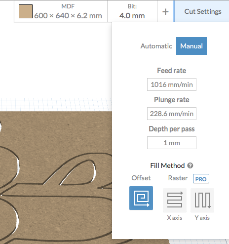

I recon these values are too much for your machine.
4mm bit, 1mm depth per pass at 1000mm/min is probably too much for your machine to handle.
What kind of 4mm bit do you use?
Screen Shot 2021-04-06 at 16.03.16
I am using a 4mm straight cut tungsten bit. I also tried last night a slower feedrate of 726 and a 0.7mm pass and it did it again
