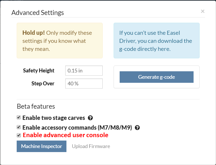

I would also like to see the console on the main page. Perhaps it could be optional and enabled as ā€œAdvanced User Consoleā€ or something. Some mock ups of what I was thinking:
Excellent suggestion, I have been thinking about that for a while now, even a ā€œmachine inspectorā€ shortcut on the main screen would be nice.
Cmd + Shift + D does that! :wink:
Suh-Weet !!!
DOH! Thatā€™s awesome!!
