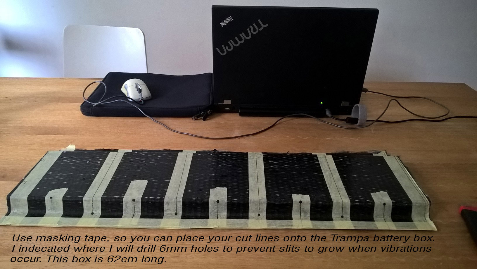

I would like some advice from you if that’s not asking too much. I have several enclosures (other style) that I need to mill into. I think there are several approaches to make this working.
The box
First, this is what I do manually and it"s a PITA!
So with the XCARVE, this should be way easier, directly in easel. My question is what would be the best approach.
  1. Create some 4mm x 50cm boxes as you can see one on the picture below? That should make the sides. I set the home manually and it’s working well.
Now the question is… what about the horizontal lines because these are not the same height.
Should I consider this as a whole box (by putting the good dimensions in the material) ?
