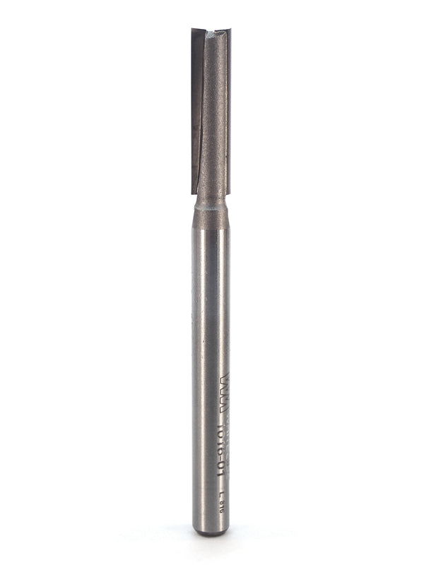

I need a little help, I am building a guitar and i need router bit for my x carve using my Dewalt 611.
I need to cut a depth of 1 12/16 in. depth. the guitar body is 1 3/4 thick plus 1/8 for the wasteboard.
thank you for any help. Merry and safe Christmas to all.
Look for bits at Whiteside or toolstoday for long bits.
Check out compression bits, I use 6mm compression for deep cuts and they seem to cope better imo
