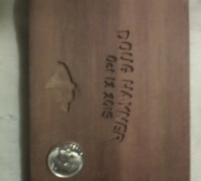

Ok the bear is 1 1/2" in witdh and 7/8" tall. The Doug Hayner image is 2 7/8" wide.
Now if the image is engraved (or carved?) dead center on work piece (a nice dk. walnut, or dk. mohogany) the wood piece would have to be 4 1/4" wide x 2 1/4" tall. Could be bigger to give me play room, but that is minimum. Again thickness would have to be 3/8".

I played with it last night, using a 1mm end mill here is what i came up with. wood is Massaranduba, a south american hardwood.
for the final piece i would cut the blank oversize and make all the images on it.
You could then cut it however you wish to suit your needs

I ink it looks great. On the final cut though I will need more bare wood space between the bear image and the text and each is for different sides of course. And yes I love the dark wood best. Awesome job! Thanks
