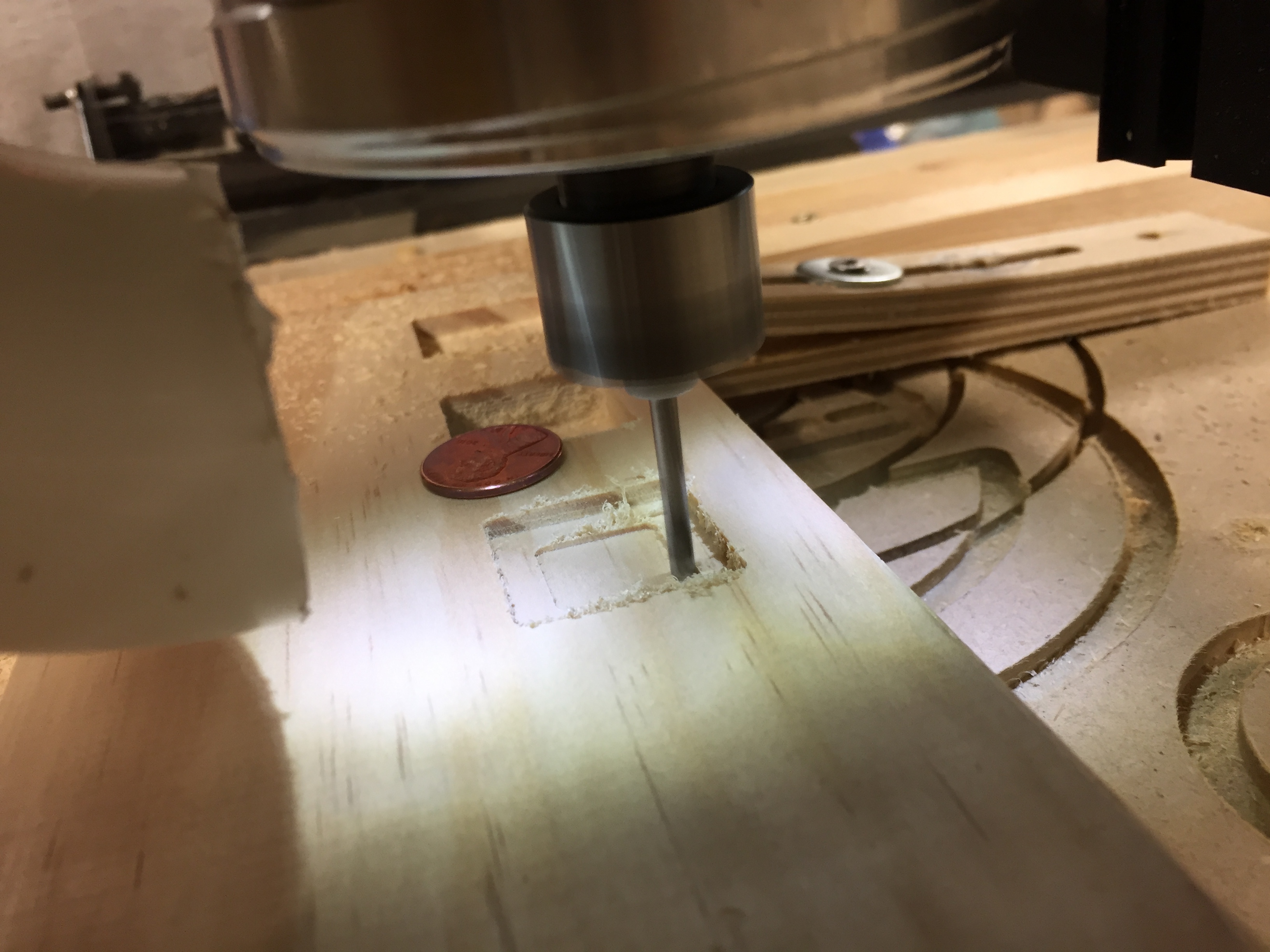

We have been using the x-carve for over a year and have had a problem with the initial z plunge the entire time. The machine has an acme rod, has a stiffened x axis and all belts, wheels, pulleys etc are tight. We are quite fastidious about setting 0,0,0 (z is set to one paper thickness above the work surface). The first plunge is erratic.
We set up a test to cut 4 pockets from 1/8" deep to 1/2" deep. Default Easel settings for speed and plunge rate we used. This shows one of the pockets during the second z pass:
Note the depth of the first pass compared to the second (and subsequent) pass. The pockets were all 1/16" to 3/32" deeper than modeled after completion.
We set up for another test and here is the first pass:
Looks close to the right depth! More tests and the first pass was too deep again.
Any help would be appreciated. We have several tweaks to make (steps/mm on all axes, planing spoilboard, etc.) but we don’t want to start those until we can solve this problem.

We have gone with the default 188.976 setting since subsequent layers seem to be the correct depth. It’s the first plunge that’s definitely much deeper than it should be. Changing the Z steps would result in all layers being off instead of just the first, right? It’s possible that the Z steps may need further calibration after we figure out this “first plunge” issue.
I’ve also checked the GCODE coming out of Easel, and it looks pretty sane as far as that first plunge and subsequent layers go (comments are mine):
The only difference is that first plunge is going a total distance of 0.178" instead of 0.028". We have not updated the firmware since the initial build/setup, but it doesn’t look like there have been any real commits to the firmware repo since 2015. The issue is consistent across OS X (Easel and grblweb), Windows 10 (Easel), and Raspberry Pi (grblweb). We have not adjusted the pots in a while. Would an under/over powered motor cause the inconsistency on the first plunge only?
